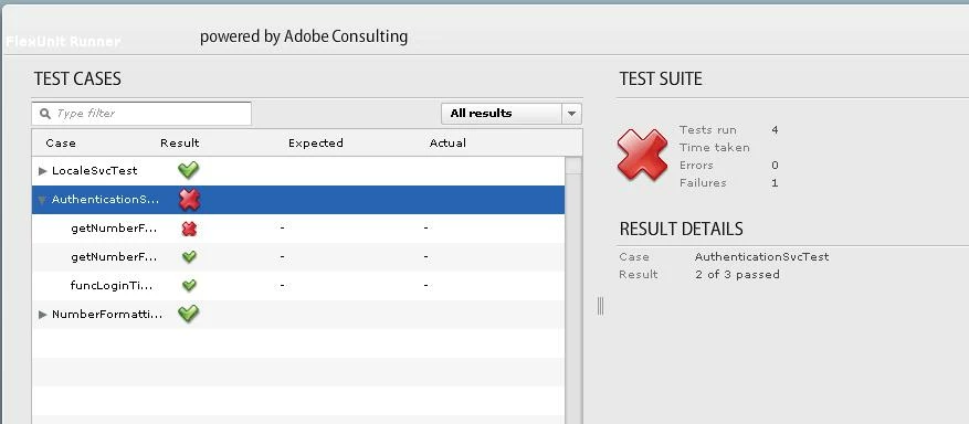

Hello guys,
I have 3 test class out of which 2  test class is fully passed. But the class which fails has 2 methods. In the failed class 1 method is failed and 1 is passed, but when i check in the flexunit UI it says for the failed class as Result: 2 of 3 passed. But there are only 2 methods, It counts that as passed as well as failed. Can anyone tell me the reason. For reference i am attaching the screeshot.

Rupam,
This was a bug in the beta 1 code, which I believe you are running. If you want to grab the latest code from XVN, or wait until beta 2 is posted shortly, this will be fixed.

Rupam,
From what I am understanding, you have 3 classes, one of which has two tests included in it.  One of these tests is failing and one is passing.  If they are two seperate tests this is indeed possible.
Can you post a copy of your code?  In order to see the issue we would need to be able to see the code you are running to arrive at this result.  Specifically can you include the class which is having the problem.
Joe

Rupam,
Mike

Thanks Mike,
I was expecting the answer from you, cause i checked with very simple example and in the UI it results me wrong. Well can you say approx by how much time flexunit beta2 will be out.
