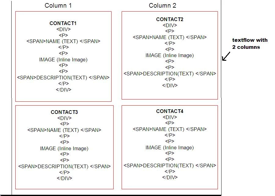

Column layout is 2
Ideally i want to show 4(can vary) contacts at a time..please see image.
I have added the contacts to Textflow and set the container size to 700 X 600 and coulmns to 2.
Problem:
Sometimes when i try to fill contact details  eg : if USER DESCRIPTION is too large, the text overflows
from 2nd column,and it gets overlaps with the first contact in first column
example in image link if 4th contact description data is very large.
whenever dynamic text is larger,text flows.
Also i dont want to use an individual textflow for an contact as it will be difficult to manage?
(or would it be easier??)
Ideally a single flow holds multiple contacts is needed.

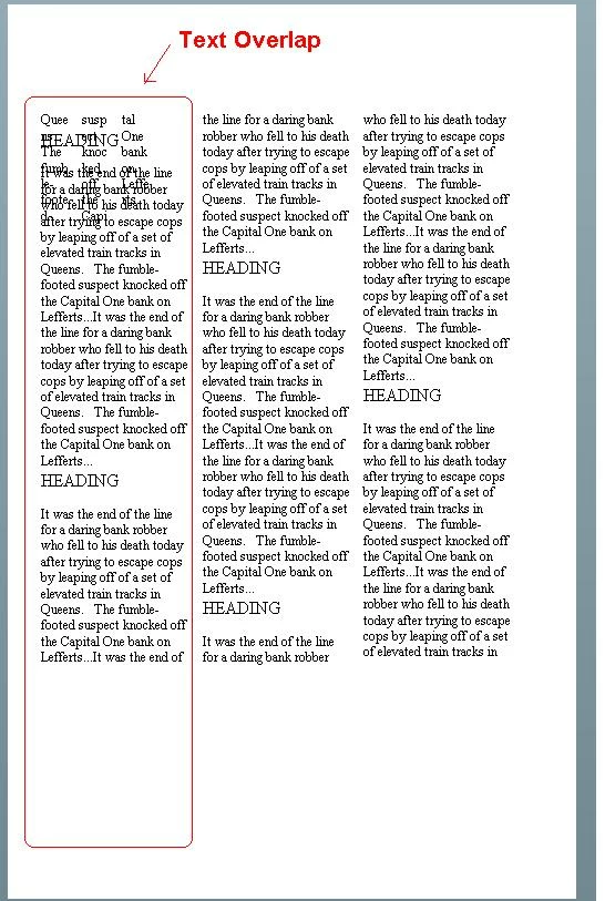

Still i think it would be better if  i will show you guys what exactly is going wrong.
This a slightly modified version of columns example from TLF examples.
I'm using flex builder 3.2 and slightly older version of TLF :  textlayout_framework_p1_111808
Here the code sample i modified to
i have attached the same file.
To simulate overflow and overlap i called addFlow() 6-7 times..calling it 4 or less times does cause overflow .
So i wanted to know is there a way to know if the text i'm going add will cause a overlap??
Or Is there a way to possibly avoid adding text to TLF if required text is going to cause overflow?
or possible checking remaining height of TLF before adding?
i just want to know the the text wiill overflow so i can shift that text to next canvas or textflow.

The overlap you see here is because you've added two container controllers using the same container (mainSprite). I'm not sure if that's what you intended. If your use a single container contoller or multiple container controllers with non-overlapping containers, you will not see the overlap.
You can still overflow. There is no way to know that a text flow will overflow without actually composing it. Once composed, you can detect overflow by comparing the cumulative textLength of all container controllers with that of the textFlow. If the latter is higher, overflow has occured.
You can deal with overflow in many ways
- Enable scrolling
- Keep scrolling disabled and let TLF display only as much text as fits.
- Keep adding more containers and recomposing until everything fits
- Remove trailing text to the point where it makes sense in your application (for example, drop the last contact if it only fits partially) and recompose
