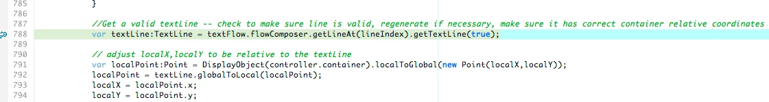

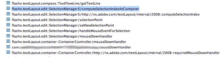

The stack that creates the problem is like this, basically starts with user trying to click into the TextFlow, and TLF trying to figure out what anchorPosition was selected
The actual exception is on line 792, where "textLine" is NULL when "globalToLocal" is called.

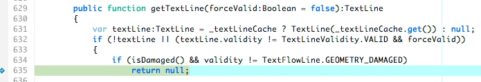

It is NULL because TextFlowLine:getTextLine returned NULL due to the highlighted condition below at line 634
SelectionManager.as
The code below is prepared to validate if the "validity" state is set to "geometryDamaged",
but, the state is set to "invalid", and it can't deal with that, so it returns NULL, and the code in computeSelectionIndexInContainer blows up.
So, the question is:  Why is this textline "invalid", is it supposed to be?  Did we find the wrong TextLine?
TextFlowLine.as
