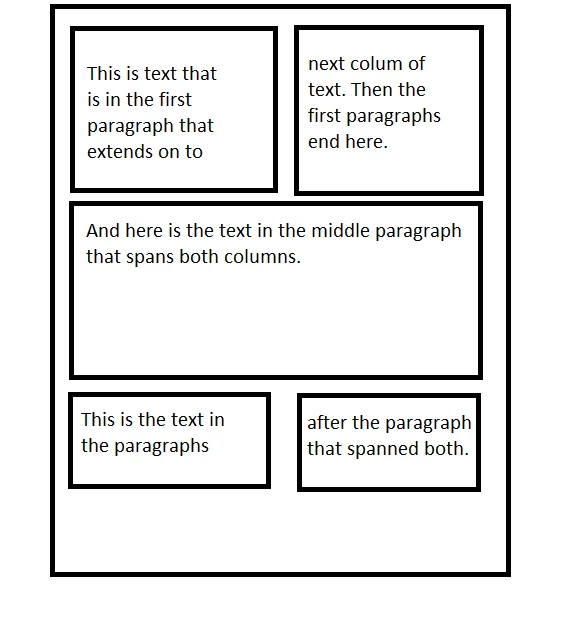

I know this isn't supported in any current version of TLF but nonetheless this is what our customers want.
Our customers want the ability to have a single page of text with two paragraphs of text set to two columns, the next paragraph only one column then the last paragraphs on the page be two columns again.
What do you think the best apporach to allowing for this functionality? I know the Times Reader did something similar to this.

3. Instead of having one ContainerController per page, during composition dynamically size ContainerControllers and have multiple per page. We would rather not do this due to it further hurting performance.
If you have multi containers and let textflow flow within those containers, there is a TLF 3.0 new feature "ContainerBreakBefore & ContainerBreakAfter", which can help you to easily implement your layout as the picture shows. But 3.0 has not yet been picked up by Flex SDK.
