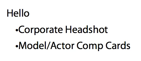

Just to add to my last post, I am using the following code to simulate the text that would be returned for display:

I get this:

I believe this question - setting the space between marker and text in list - has been answered a few days ago by either Robin or Richard.
Here is what works for me:
<list paddingLeft='yourRequirement' textIndent='0'><listMarkerFormat><ListMarkerFormat paragraphEndIndent='yourRequirement'/></listMarkerFormat><li><p>...</p></li></list>
One thing to mention is that setting listStylePosition='inside' negates the space between the marker and the text set by 'paragraphEndIndent; at least for me. So I have to either set it explicitly to 'outside' or just omit it altogether relying on default.

See page 3 of this PDF for getting space between your inside list marker and the text.
http://blogs.adobe.com/tlf/files/tlf/Lists.pdf
Note your example has an error:  replace afterFormat with afterContent.
The AS3 docs talk about tabStops here.
http://help.adobe.com/en_US/FlashPlatform/reference/actionscript/3/flashx/textLayout/formats/TextLayoutFormat.html#tabStops
