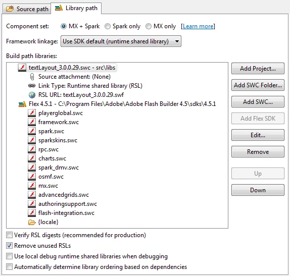

I'm trying to use TLF 3.0 in my Flex 4.5.1 project. I add the textLayout.swc as a library and remove the textLayout.swc from the SDK in the "Library Path" of Flash Builder.
The link type is "Merged into code".
But when I run my Spark Application, I got the following message :
"VerifyError: Error #1014: La classe flashx.textLayout.container::TextContainerManager est introuvable."
I have no preloader, my project is compiled against Flash 10.2 (required by the Flex SDK 4.5.1).

KnuX75002Author
Nov 29, 2011 3:58 PM UTC
Grrr finally, it doesn't work. I replaced the textLayout.swc in "C:\Program Files\Adobe\Adobe Flash Builder 4.5\sdks\4.5.1\frameworks\libs" with the swc from TLF 3.0. I have the SDK in RSL but for textLayout.swc I choose "Merged into code" and I still have the VerifyError.
It works only if I have Flex 4.5.1 SDK and additionnal lib textLayout.swc as "Merged into code" (and I remove the textLayout.swc from the Flex SDK in the Library Path).  If I put the SDK in RSL mode, the error occurs :/
In fact, I cannot have all the framwork merged into code, my SWF will be too big
KnuX75002Author
Nov 29, 2011 4:34 PM UTC
Hm, OK. I force the textLayout.swc to be the first library loaded, in RSL, with the extracted .swf deployed on my server and it seems to be OK. Both TLF 3.0 and Flex 4.5.1 are in RSL
