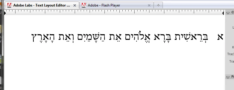

Jun 22, 2010 5:33 PM UTC
Running http://labs.adobe.com/technologies/textlayout/demos/ with Flash Player 10.1.53.64, using Adobe Hebrew looks good to me:
Is this output correct?
Eric.
Jun 19, 2010 12:08 AM UTC
It looks like DavidD is a truetype font from 1997, so I expect it does not have the OpenType tables we're looking for. I don't have it installed, so when I import your markup the diacritical marks line up correctly (since we're using font fallback at that point).
You should try a "formal" Hebrew OpenType font. Unfortunately I'm not that familiar with Hebrew fonts or what would make one formal. I do know that our fallback font and Adobe Hebrew are positioning the marks correctly.
