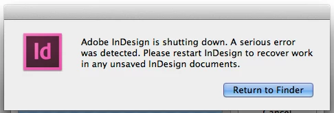

InDesign shuts down...A serious error was detected.
I'm getting this alert after opening an InDesign document and then updating an ".icml" link. I'm having no other issues with InDesign files, only those that have changes made in InCopy.
The document is created using InDesign CS6 and worked on with InCopy CS6 (latest versions). I am able to open the InDesign file as long as I don't update all the links when opening the file. I've tried isolating which ".icml" link is causing the problem without success.
I would appreciate any help. Thanks!
