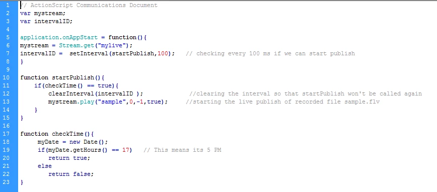

    Hai there. Thanks a lot. I have tried create the folder as u mentioned above and save the "sample.flv" file under _definst_ folder as figure below.
    I also have created "main.asc" document under test folder using your above code. I also changed the time to 5PM (as the time here).
    Then for Flowplayer coding I made as below:
    $f("fms", "flowplayer-3.1.5.swf", {
                    clip: {
                        url: 'mylive',
                        provider: 'rtmp',
                        autoPlay : true,
                        live: true
                    plugins: {
                        rtmp: {
                            url: 'flowplayer.rtmp-3.1.3.swf',
                            netConnectionUrl: 'rtmp://myIPaddress/test/streams/_definst_/'
    Except for the flowplayer coding, was everthing I have done above is correct?? If correct then it must be something that I need to change inside the flowplayer coding.
    Just make one change:
    Instead of this : netConnectionUrl: 'rtmp://myIPaddress/test/streams/_definst_/'  use 'rtmp://myIPaddress/test"
    Please let me know if this works.
    Also if possible , try without date logic, see if it plainly works. Then we can work on date logic once we know that play is working fine.

    Its very simple. You just need to use Stream API on server-side to achieve this:
    Say you have recorded filed named "sample.flv" and want to stream it as live: So you need to have following server-side code:
    var myStream;
    application.onAppStart = function(){
         myStream = Stream.get("mylive");
         myStream.onStatus = function(info){
              trace("Stream status:"+ info.code);
         myStream.play("sample",0,-1,true);
    Client needs to subscribe to "mylive" - ns.play("mylive",-1,-1,true);
    Above is bare minimum code , if you need any more help do let us know.
