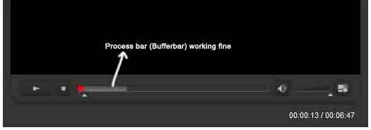

I am using a flvplayback for video playing when I use http path for video it show bufferbar working perfectly like below:
Code:
_flvPlayback.source = "http://flash.projectstatus.in/fmsvid/sample.flv";

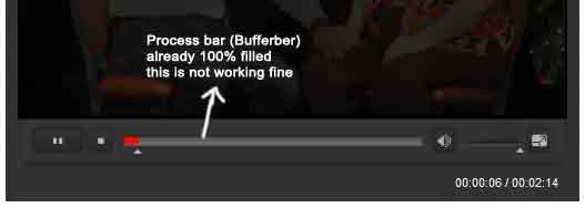

If I use rtmp path from the fms the bufferbar does not work it shows already full like below:
Code:
_flvPlayback.source = "rtmp://75.126.73.138/vod/flv:sample.flv";
In both case video playing perfectly. Only problem regarding buffering bar.

Dhaval__Dotsquares_
Feb 10, 2012 11:27 AM UTC
Hi SE_0208,
Thanks for your reply. but the issue i am facing is that why rtmp streaming does not shows up the buffering in a progressive way as it is happening in http streaming. although, in both, video is playing perfectly which means that data is downloading fine. so, can you please suggest how to show the progressive download with rtmp streaming?
