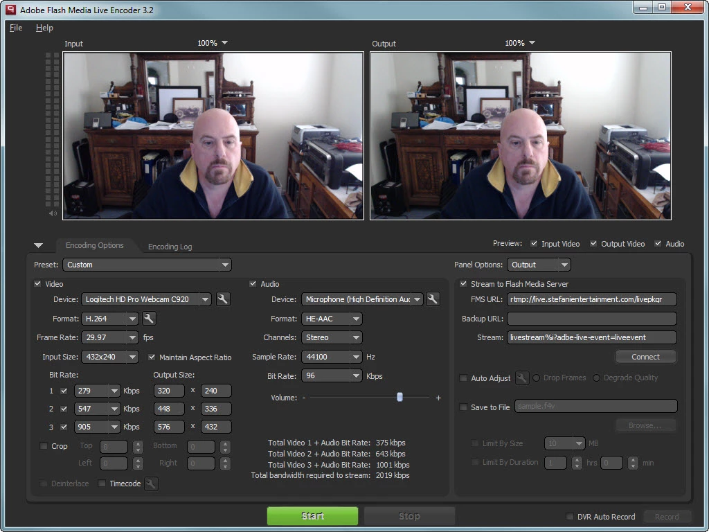

I am having issues with the client side on different devices once they click on play.  I've tried a single bit-rate, multi bit-rate and they seem to get "buffering..." and it sits there or goes to a black screen.  When I check the performance of the stream, I'm getting very good readings (20% CPU, 10% memory and 2 Mbps total bandwidth consumtion).  I have fiber at my office running 20/20 which is plenty of bandwidth to support 3 streams.  I've tried various frame rates and bitrates using H.264 and AAC. Ran accross a grat article/calculator for optimal frame dimensions and bitrates for Flash video (http://www.adobe.com/devnet/flash/apps/flv_bitrate_calculator.html). In FLME, my last configuration was as follows:
As you can see, I'm using 3 streams and total bandwidth consumption is 2019 which using Robert Reinhardt's calculator is more like 2400-2500.  Still plenty at 12% of bandwidth consumption.  I've tried knocking it down to a single stream (lowest footprint) and still get the "Buffering..." issues.  Any ideas here?

Your settings looks ok for me - i am not sure the change i would recommend is one which is causing the issue - but i think you should try it out. I think your audio bitrate is way too high - for what is recommeded by Apple - can you bring to 40kbps and see if that makes any difference. Also is FMLE and FMS are on same machine or on two different machine - i just want to be sure CPU numbers which you have given are FMS machine based and there is no other major process which is taking CPU cycles.
