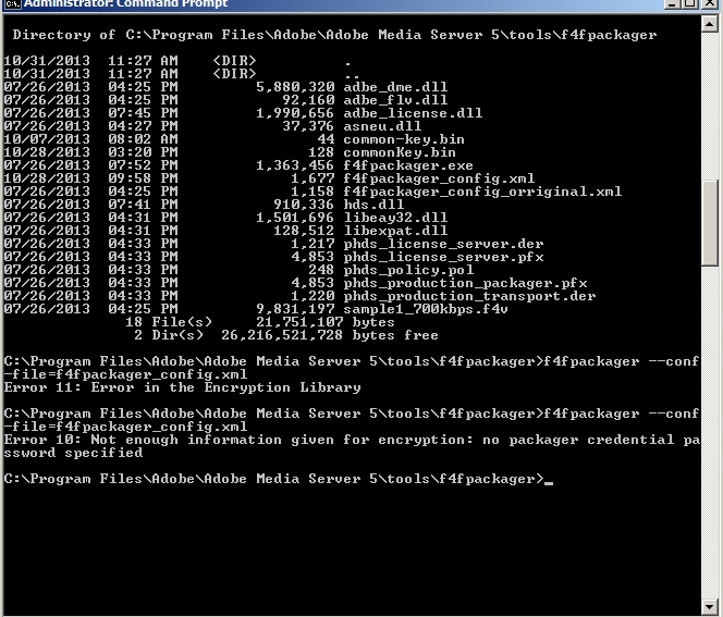

We are trying to use the f4fpackager to package and encrypt files to test PHDS. The command fails because we don't enter the correct credential password for the required parameter --credential-pwd=.
According to the packager reference docs, the password string is used to secure the packager credential which we understand to be phds_production_packager.pfx.

Below you can see the errors. We have copied the certificates and media to the f4fpackager to keep things simple.
Error 11 is the result of entering a string for the password.
Error 10 is the result of not entering a string.
Where can we get the credential password? Please Media Server Team. Help us so that we can go ahead with the purchase.

The password which has been used to create packager-credential file (.pfx), is scrambled using the Scrambler tool bundled with FAXS and is used as credential-pwd.
EastManAuthor
Nov 4, 2013 2:35 PM UTC
Thank you for your reply Chandan_Abhisheck.
Where is this Scrambled string? Are we supposed to have access to this scrambled string or do we need to create another one by runing the scrambler tool ourselves? Maybe we are missunderstanding the directions on how to package and  encrypt content?
We do have a trial version of Adobe Access Pro, but we have not used it yet.
Nov 5, 2013 5:00 AM UTC
For PHDS, you don't have to use Adobe Access Server and it is used for content protection for HDS using Adobe Access. You can go through following link to know more about content protection:
http://help.adobe.com/en_US/adobemediaserver/devguide/WS5262178513756206-4b6aabd1378392bb59-7fff.html#WS5262178513756206-4b6aabd1378392bb59-7ffdhttp://help.adobe.com/en_US/adobemediaserver/devguide/WS5262178513756206-4b6aabd1378392bb59-7fff.html
Also, you can look for the corresponding tags in the f4fpackager as mentioned in the above link for PHDS.
