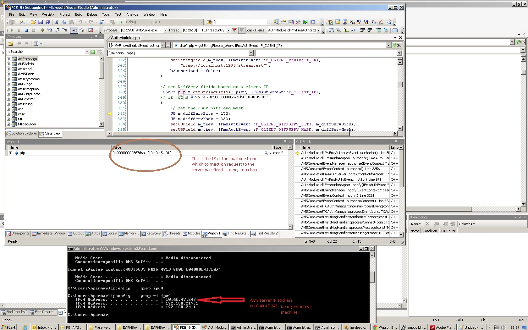

I wrote a small auth adaptor and it returns correct IP address(just as expected)...I am attaching the debugger screen shot as a proof of that...
Oct 10, 2014 7:32 PM UTC

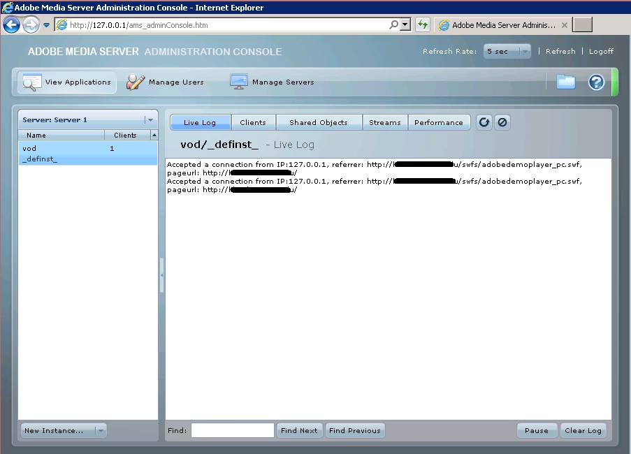

Oct 10, 2014 11:49 PM UTC
New update: I just installed the latest AMS on Windows Server 2008 R2 and I'm still getting the 127.0.0.1 as the client IP. This was a fresh install. Here's a screenshot of the admin console. So it looks like it may not be working as intended on the latest version? The only one I could see the client's IP address was the existing FMS 3.5 that we had.
