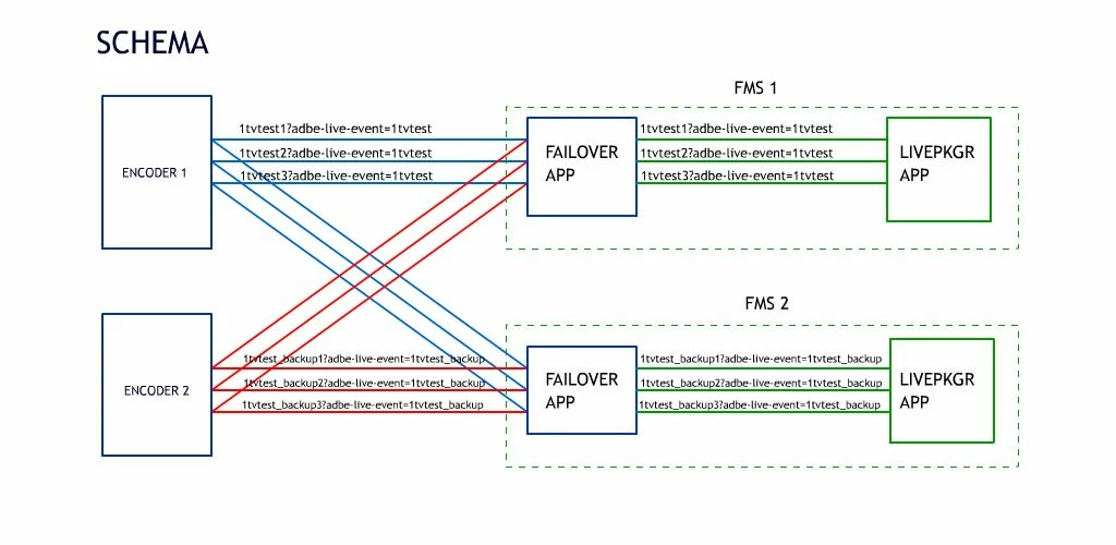

VasilyTTAuthor
Apr 13, 2012 8:21 AM UTC
Architecture of Integration

VasilyTTAuthor
Apr 12, 2012 7:34 AM UTC
It's important.
I publish multibitrate streams ( 3 primary and 3 backup ) to my failover application,
It have 3 multibitrate NetStreams to LIVEPKGR.
It reattach primary or backup stream to one NetStream in my Failover application..
I set syncronization true in FMLE, but I dont know what's happenen inside NetStream reattach process.
