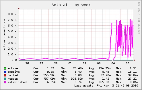

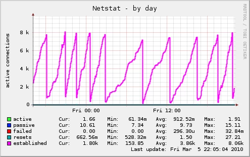

The last red line can be visualised below; sometimes the server crashes in out of memory kernel panic...
And if you compare with previous behavior, you can tell when we did the upgrade to FMS 3.5.3...
