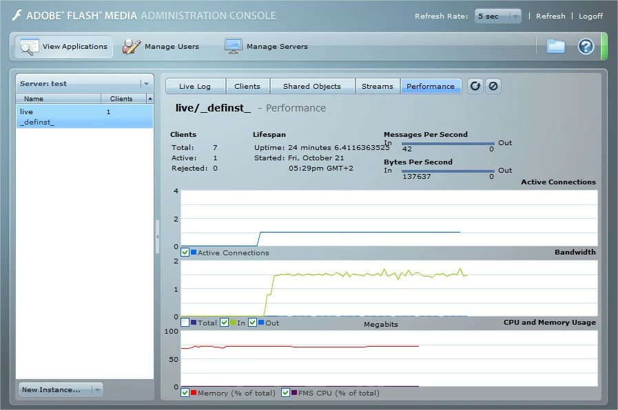

    Addition: I've found out that the incoming bandwith is very constant when streaming and encoding from FMLE. It stays relatively constant around 1500 kbps:
    When I am using the Flash Player 11 for encoding and streaming the incoming bandwith looks like the rocky mountains. The incoming bandwith jumps between 1000 and 6000 kbps during the whole stream:
    That is definitely the reason why it "stutters" when using Flash Player 11. But I have no idea what I am doing wrong.
