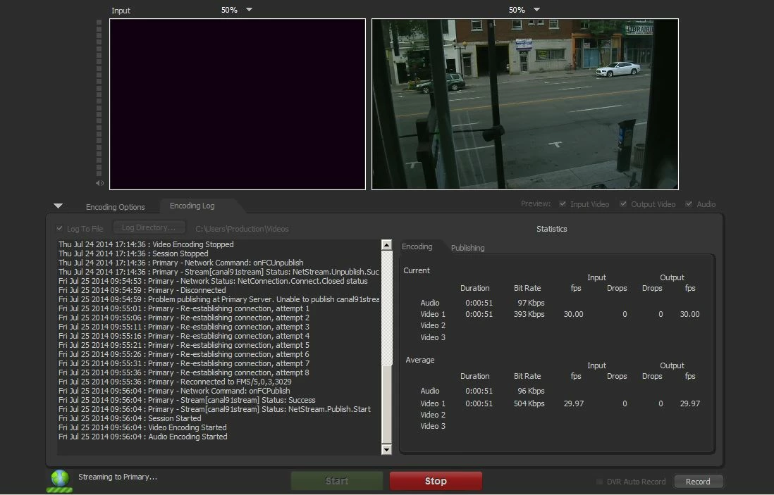

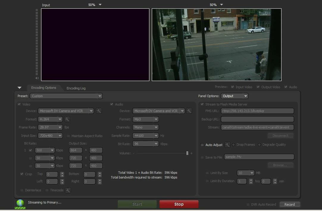

We just began using AMS for live streaming with HLS and we encouter some serious issues. Our first commercial live event is scheduled to next Wednesday and we cannot afford to lose our customer so your help is greatly appreciated.
We have two issues which are probably related :
  1. When we start streaming all goes well for the first couple minutes but passed that point the stream gets less fluid. In the video player you can see a pause - dropped frames? - then the stream resumes fines. Then after say 30 seconds another pause and so on. If we stream for long enough the player finally goes black and the stream cannot be resumed.
  2. We experience some random AMS service shutdown every other day or so. The server just stops streaming for an unkown reason. Please have a look at our edge log below. Looks like we have some recuring "bind failed" errors but I have no idea if they are related.

    FMLE screencaps :
    Jul 29, 2014 1:15 PM UTC
    Update : point 1. above has been resolved. After investigation we found out that was a player issue.
