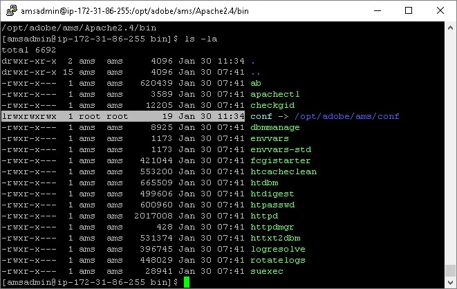

    While we are working on the issue, a workaround would be to create a softlink as shown in attachment
    Or You can do following steps
    sudo mkdir /opt/adobe/ams/Apache2.4/bin/conf
    sudo cp /opt/adobe/ams/conf/EC2.xml /opt/adobe/ams/Apache2.4/bin/conf/EC2.xml
    sudo chown -R ams:ams /opt/adobe/ams/Apache2.4/bin/conf
    Kindly clear your browser cache and restart your browser before testing.
    Also please let us all know if this fixes the issue for you.

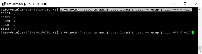

    I just realised that for 5.0.11 the link has to be created at the level of cwd...cwd of runnign process can be found out as follows
    sudo pwdx ` sudo ps aex | grep httpd | grep -v grep | cut -d" " -f1`
    See screenshot as below

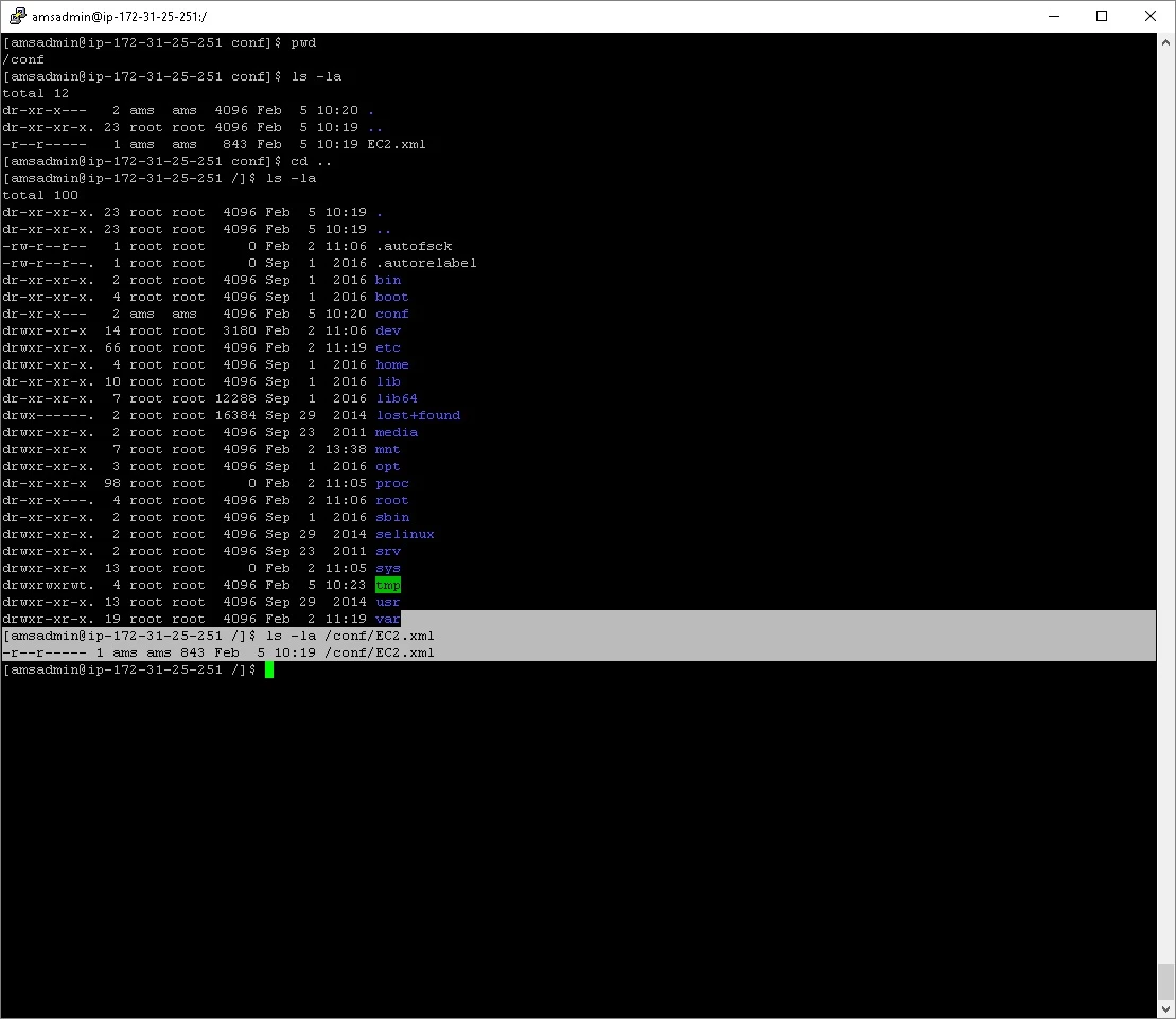

    in my case the cwd turns out to be / , so i need to create a folder conf at root level and put EC2.xml inside that...[Do not forget to change owner ship of file and folder to ams:ams ]
    See screenshot as attached.
