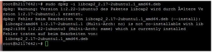

    Hi, I try it, but i get this error:
    my serverinfo:
    Prozessor: Intel Sandy Bridge G530
    CPU-Leistung: 2 x 2,4 GHz
    Arbeitsspeicher: 4 GB
    Ubuntu 12.04 LTS Server 64bit
    Jan 22, 2013 4:45 AM UTC
    Sorry, that was for AMD processor. Try installing libcap from http://archive.ubuntu.com/ubuntu/pool/main/libc/libcap2/libcap2_2.17-2ubuntu1_i386.deb which is for Intel processors.
    Download the file using wget and install the deb using sudo dpkg –i libcap2_2.17-2ubuntu1_i386.deb
