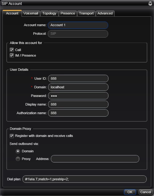

    Which version of x-lite are you using? I am still not sure what may be causing this on your setup.
    On the example setup from which above logs were generated, x-lite 4 was configured as shown on the picture below. It was installed on the same machine as FMG.
       Do let know how it goes, if the problem persists; please share the SIP packet capture. Instructions to capture SIP packets should be searchable in few older threads.
