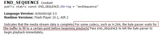

In Adobe document, I find this information and I try to use the END_SEQUENCE several ways, but all of them do not work.
Is there a way to play the H264 tag immediately without buffer?
