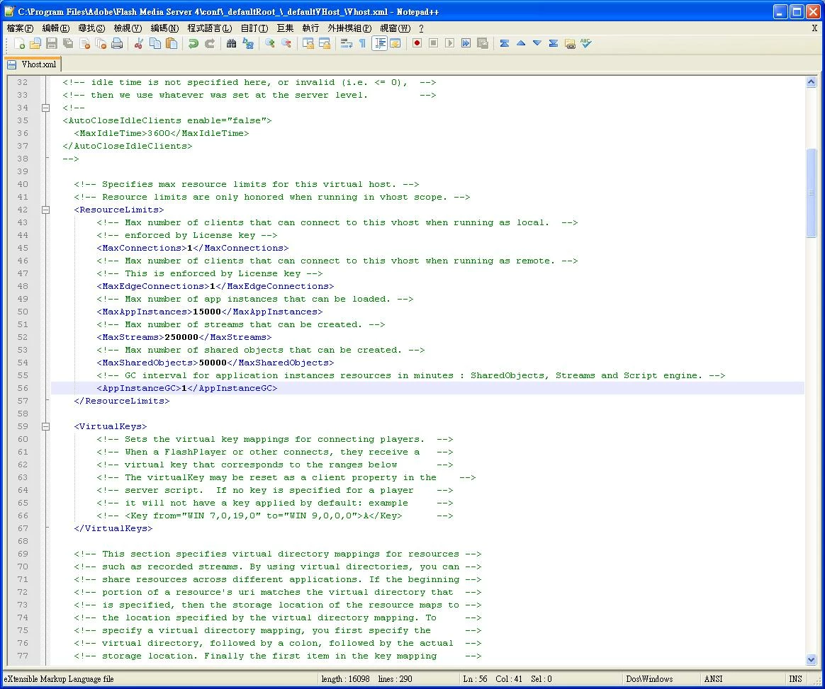

I have changed the variable <MaxConnectionRate>2</MaxConnectionRate> base on the URL - "Limit connection requests",but more than 2 client can connect to the server.
Is that other settings to config to restrict the number of simultaneous users?
Thanks!

    <MaxConnectionRate> tag talks about rate at which connections are accepted or processed by server. It wont limit number of simulataneous connections at any given point of time. You can use MaxConnections but that will limit at vhost level (http://help.adobe.com/en_US/flashmediaserver/configadmin/WS5b3ccc516d4fbf351e63e3d119f2926bcf-7ff6.html#WS5b3ccc516d4fbf351e63e3d119f2926bcf-7e7d)

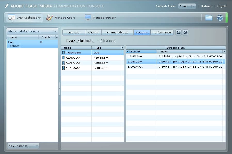

    I have changed the <maxConnections> tag to 1 in Vhost.xml (_defaultRoot_\_defaultVHost_) and restart the services, which assume there are only one client can view the video file.
    But i found out that there are severals client can connect to the server.
    Any idea can solve the problem?
    Thanks.

    Do you want to restrict at the application instance level or at the server level? If the former, you can write a basic Server-Side ActionScript file that will limit the connections to two users, and reject the others.
    -Robert
