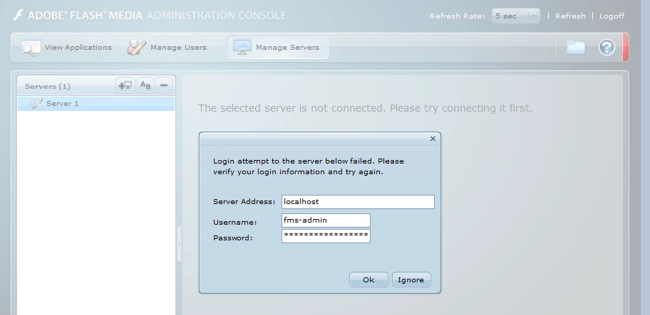

I can't log in Administration Console
Here is an iimages with my attempt:
The user and pasword  are right, the one used when I  installed FMS but it won't let me login! What I am doing wrong and where should I look for a fix?

    What version of FMS are you using?

    I'm having the same issue and I'm using 4.0
    Sep 7, 2012 3:31 PM UTC
    Hi
    For 4.0
         1. Stop the FMSAdmin Service.
         2. Open up <rootDir>/conf/fms.ini
         3. Set username. Example:
             SERVER.ADMIN_USERNAME = admin
         4. Set password. Example:
             SERVER.ADMIN_PASSWORD = password
         5. Start the server.
         6. Now try connecting.
    Also make sure port 1111 is enabled on the server.
    Thanks
