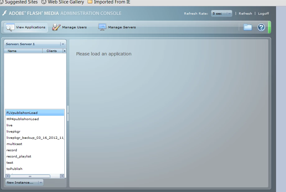

    5. go to admin console of your local development server and load the instance of FLVPublishonLoad as shown in the howtoLoadfromAdminConsole.png image attached for refrence purpose.
