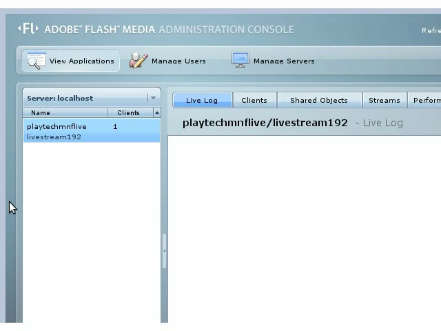

Here the simple script i put at server seem like is not working also enclosed screenshot for the adminconsole
my server side file main.asc save at /opt/adobe/fms/application/playtechmnflive/
my doing FMS edge server.
application.allowDebug= true;

    The script is fine (at least i assume u want the timer working with no errors). The thing is that u can't put any code nor apps on the edge node. Put it on the origin and hook up your edge to that origin.
