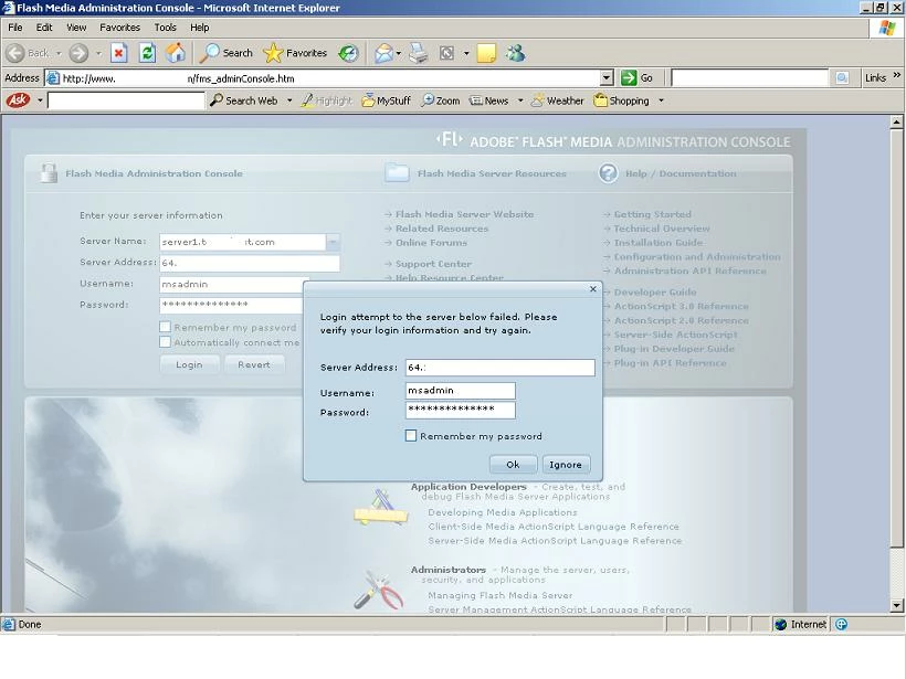

    Jun 25, 2009 12:30 AM UTC
    Hi Jay,
    Thank you for the information.   I copied the two files to a web accessible location under a virtual hosts home dir. Now i am able to browse the FMS console.
    Howerver,  i am still not able to login , even as i used the same username and pass, that is in fms.ini
    What do you put in Servername and address?
    I tried the actual hostname,  with server address both as the server IP and localhost once , but i am still stuck here.
    I also tried with serverIP:2222   /  localhost:2222  ( results the same, as 2222 is the admin service port)
    please advise.
    Please check the attached image.
    Jun 25, 2009 2:56 AM UTC
    Can you log in when running the console locally on the server? If not, try bindng the admin service to port 1111 and see if you can connect without defining the port in the server address
