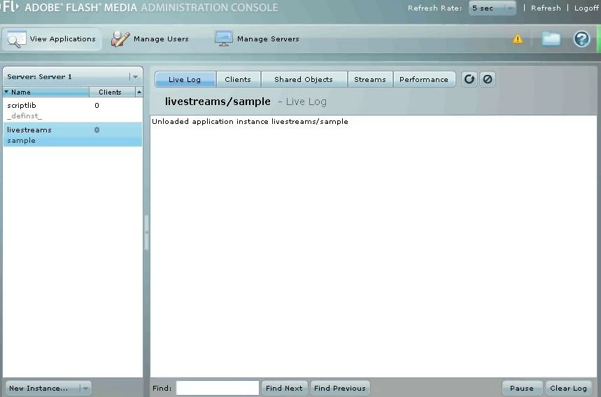

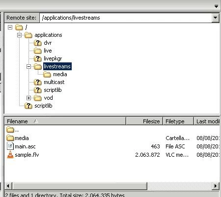

    pauljimesAuthor
    Aug 8, 2011 2:36 PM UTC
    This is my first flash application so I am very confused.
    This is my main.asc  content:
    application.onStatus = function (){
    serverNC = new NetConnection();
    serverNC.connect("rtmp://rtmp1.youtube.com/videolive?sparams=...../youtubestreamname");
    serverNS = new NetStream(serverNC);
    serverNS.attach(sample);
    serverNS.publish(sample.name,"live");
    This is my FMS directories:
    And this is my panel on the server:
    What can I do?

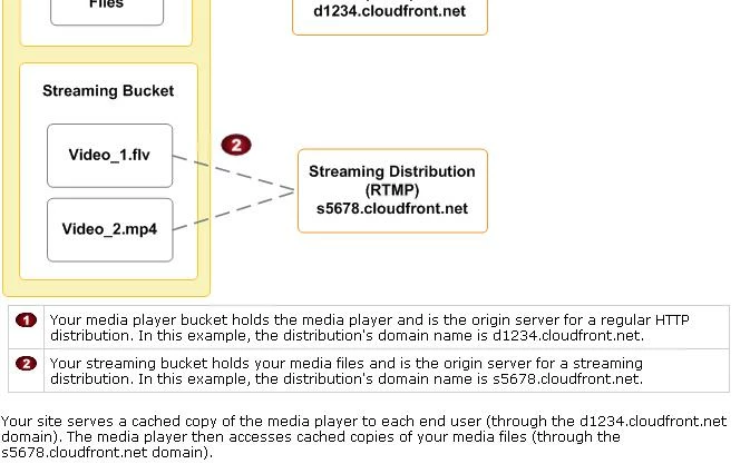

    Can I simply upload some videos on a server A (not live) and then send them to Youtube FMS?
    And do I need FMS on the server A?
    In this page on Amazon Cloudfront I found:
    Your streaming bucket holds your media files and is the origin server for a streaming distribution. In this example, the distribution's domain name is s5678.cloudfront.net.
    Can I change the distribution's domain name with youtube FMS?
    Nikhil_Kalyan
    Aug 6, 2011 7:22 AM UTC
    Yes, i think it is possible. FMS is required as long as you need to stream from that server. Else it is not required. FMS can pick up files from a network share as well to stream. Or you can write your own plugins to fetch from other locations .
    On the cloudfront, i do not think you can change it to any other fms.
