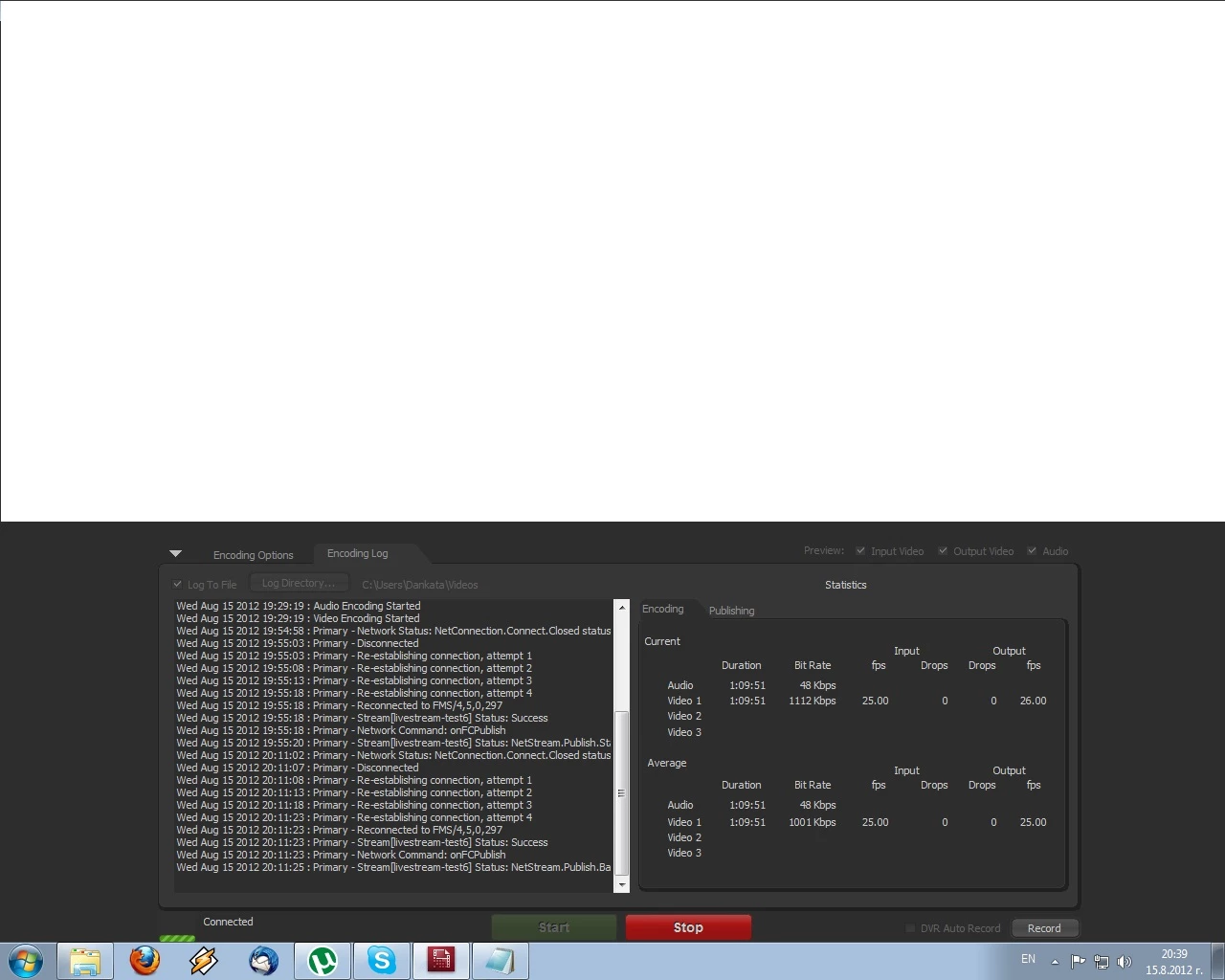

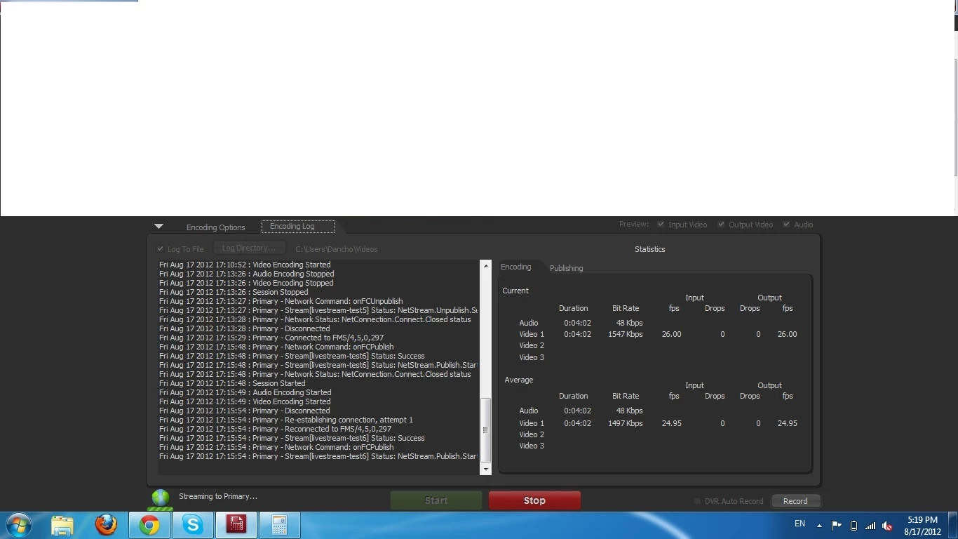

The stream suddenly stops !
I am using a PC with following parameters:
OS: Windows7 Ultimate 64bit
Matherboard: Asus p5q Delux
Processor: Intel quad core Q9450
RAM: 4GB DDR2 1066MHz
Capture card : DeckLink HD PRO DL
FMLE 3.2 detects the capture card without problems every time and everything seems to be OK. I connect to the FMS end push the start button and the stream starts but shortly after that the stream suddenly stops. FMLE 3.2 gives me messages about the situation but I can't solve the problem.
Can someone help me?
