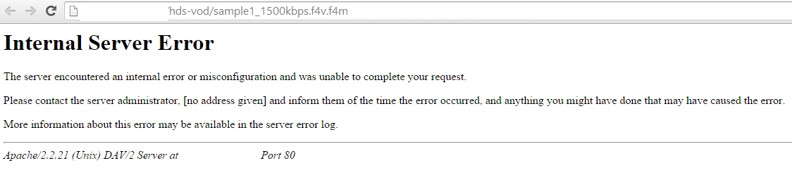

6. After PHDS configuration and restarting AMS, I tried to hit the same URL http://server-dns/hds-vod/sample1_1500kbps.f4v.f4m‌ and expecting a new XML tag "drmAdditionalHeader" inside the manifest XML. But I got the error message as mentioned below
7. Below is the error logs for the same /opt/adobe/ams/Apache2.2/logs/error_log,
[Fri Feb 27 02:11:22 2015] [error] mod_jithttp [500]: [err=1] PHDS DRM configuration incorrect in "jit.conf" : PHDS is not allowed : /opt/adobe/ams/webroot/vod/sample1_1500kbps.f4v
Also, I have already configure PHDS for AMS starter edition on windows machine with the configuration mentioned above for my POC work and I can see "drmAdditionalHeader" XML tag. But the same configuration does not work on Linux Box, can you please help me out in troubleshooting this issue, since I am struggling to fixing the same from past 2 days.
