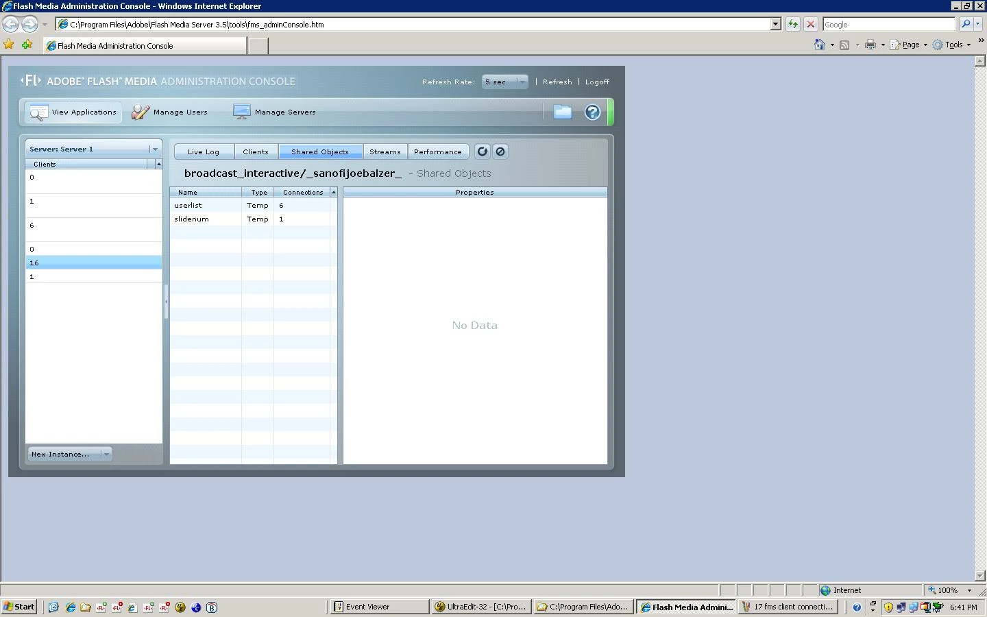

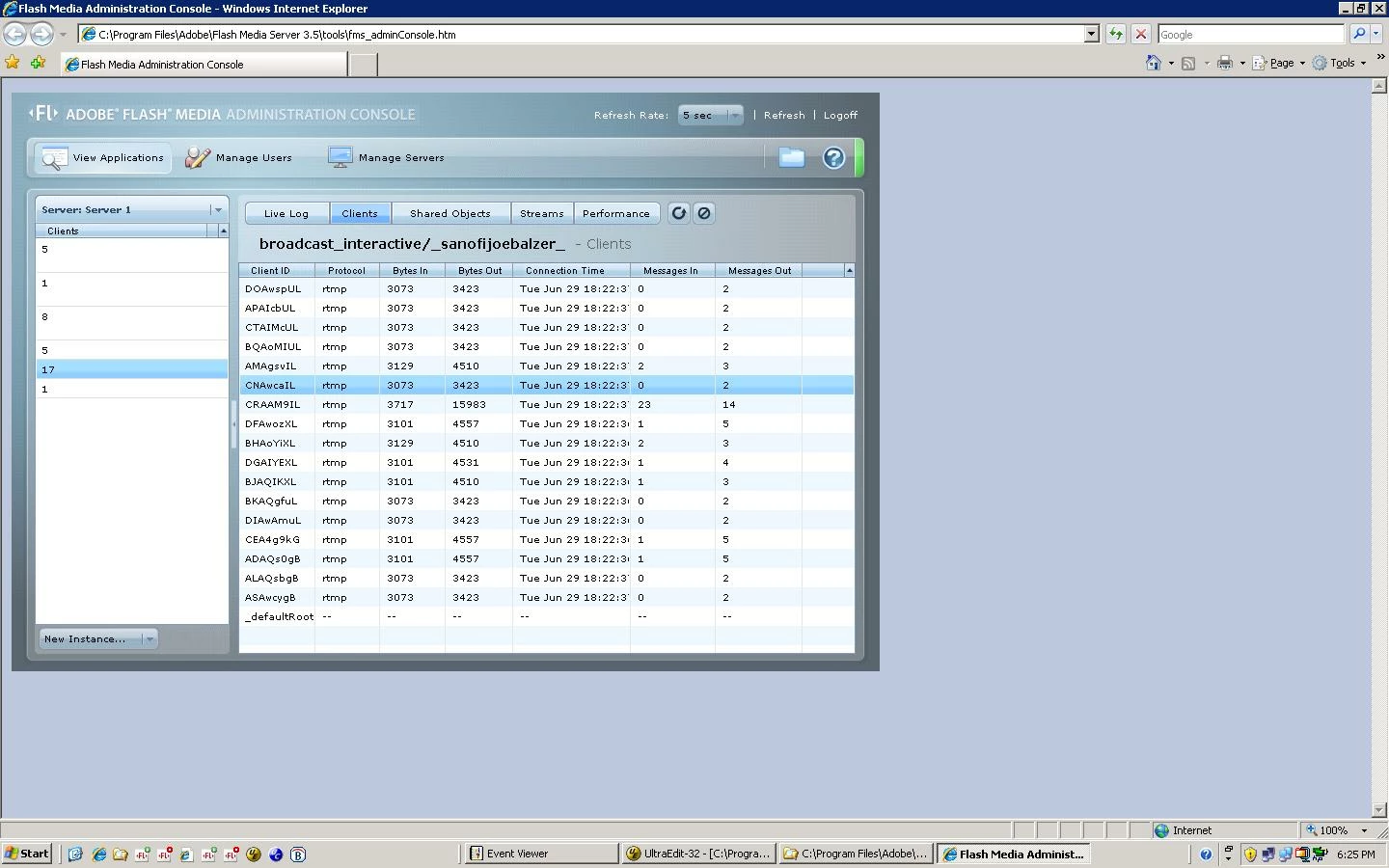

The attached image shows 17 client connections.  Unfortunately there are not 17 clients connected to that app.  In fact, I add users to a userlist shared object in application.onConnect(), and that shared object only reports 6 connections.  That is the accurate number of connected users.
Why the phantom connections?  Even if I unload and reload the app, the 17 client connections return.
How can my userlist shared object and the client connection number be out of sync?
This situation seems to be related in some way to an FMS memory problem that is cropping up all of a sudden.  When I have larger numbers of connected clients - say 300, the client connections reported in the FMS console are ten times that - like 3,000 or more.  Then the application is unloaded by FMS for being a memory hog.
The app itself is simple.  It just stores each user in a user array and passes chat communication to and from these users.  The last time this main.asc code was changed was 2/8/2010.  No problems with it in the countless times we've used it since then.  Why the sudden phantom FMS connections, memory hog behavior, and constant unloading of the app?
