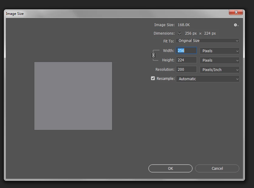

Feb 10, 2024 9:18 AM UTC
I'm glad you find it curious too!
There's no explicit unit set up in the script - as I use pixels  so assume that's been set and not changed.
Secondly, the images size is an odd 200 dpi,  256 x 224 pixels (w & h)
Thirrdly resizing the image to 72 dpi,  256 x 224 pixels (w & h) - the script works fine.
