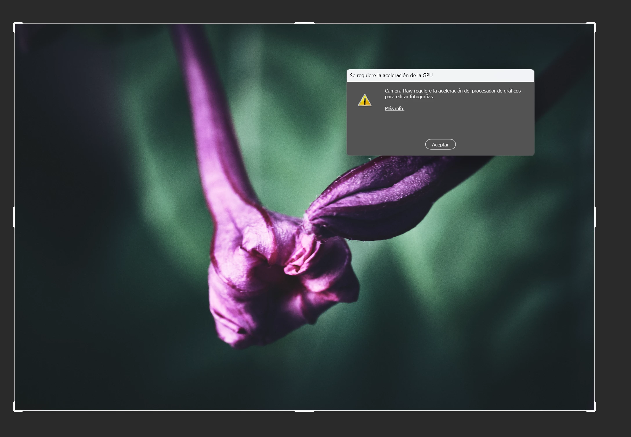

In the latest Camera Raw update, it stopped accessing graphics acceleration, and I can't activate it.
My setup:
Windows 11
NVidia RTX 5070 Ti 16 GB
I've tried absolutely everything: cleaning the card driver and reinstalling it, adding .old to the folders, resetting the graphics card, etc., and finally contacting Adobe technical support... who started by saying that the card was "old" and not suitable for Camera Raw... Adobe, if that's the case, please indicate it on your website, because supposedly my card is suitable (and if it isn't, few people will be able to continue using Adobe products). Lightroom handles everything without a problem, and the other programs that require GPU resources do too (Da Vinci, Topaz, etc.). After saying this, the card is suitable; the problem is with Windows. I honestly don't think so; it seems like a bug in Camera Raw. That's the only thing that has problems. I don't know, maybe it's a credentials issue or something.
I'm mentioning this because I think it's an Adobe error, a bug, although it'll be difficult for you to pinpoint its location because you didn't ask me for anything, and the technician requested access, but not even a bug report... Nothing.
I don't mind if it's a bug; I wouldn't have a problem with that. What I don't like is either that a bug isn't being acknowledged, or that Adobe is becoming so demanding that we have to buy a $2000 graphics card. If anyone can help, I'd appreciate it.
Thanks

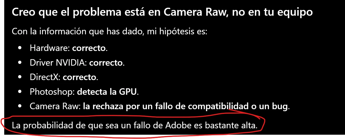

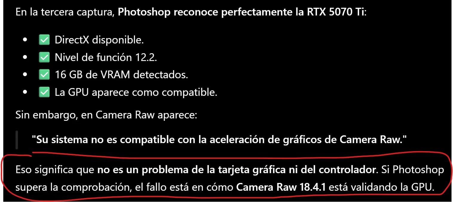

    @Sameer K

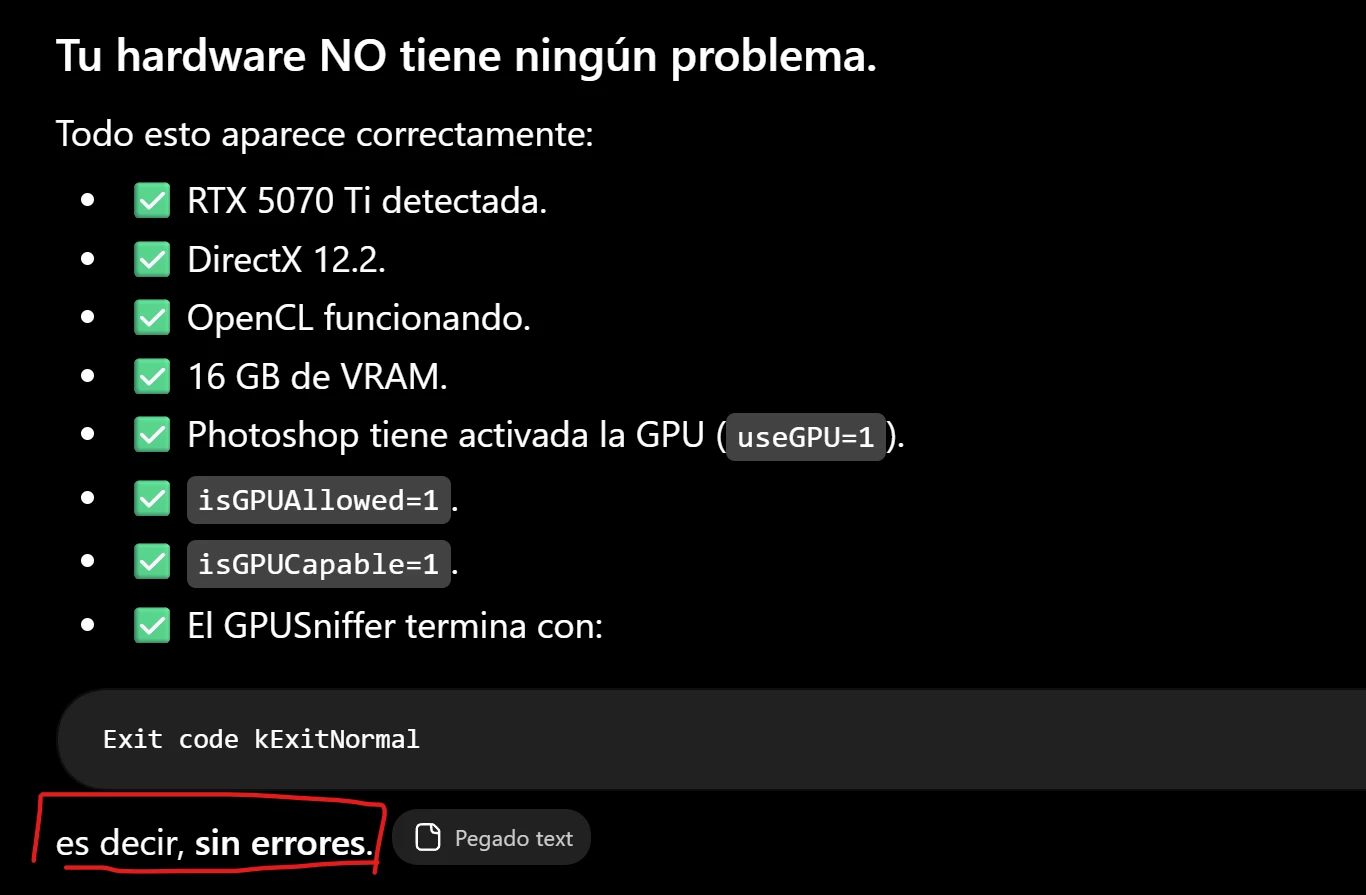

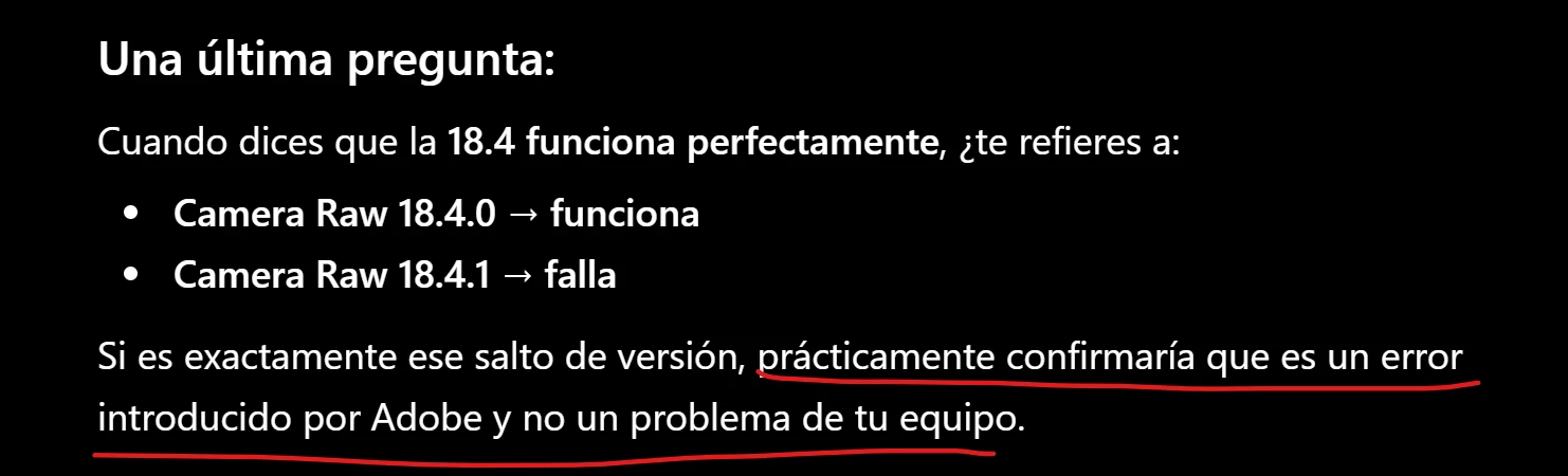

    I think what ChatGPT (and other AI) says is the problem :
    That means it's not a problem with the graphics card or the controller. If Photoshop passes the check, the flaw is in how Camera Raw 18.4.1 is validating the GPU
    The likelihood of it being an Adobe failure is pretty high
    my hardware doesn't have any issues

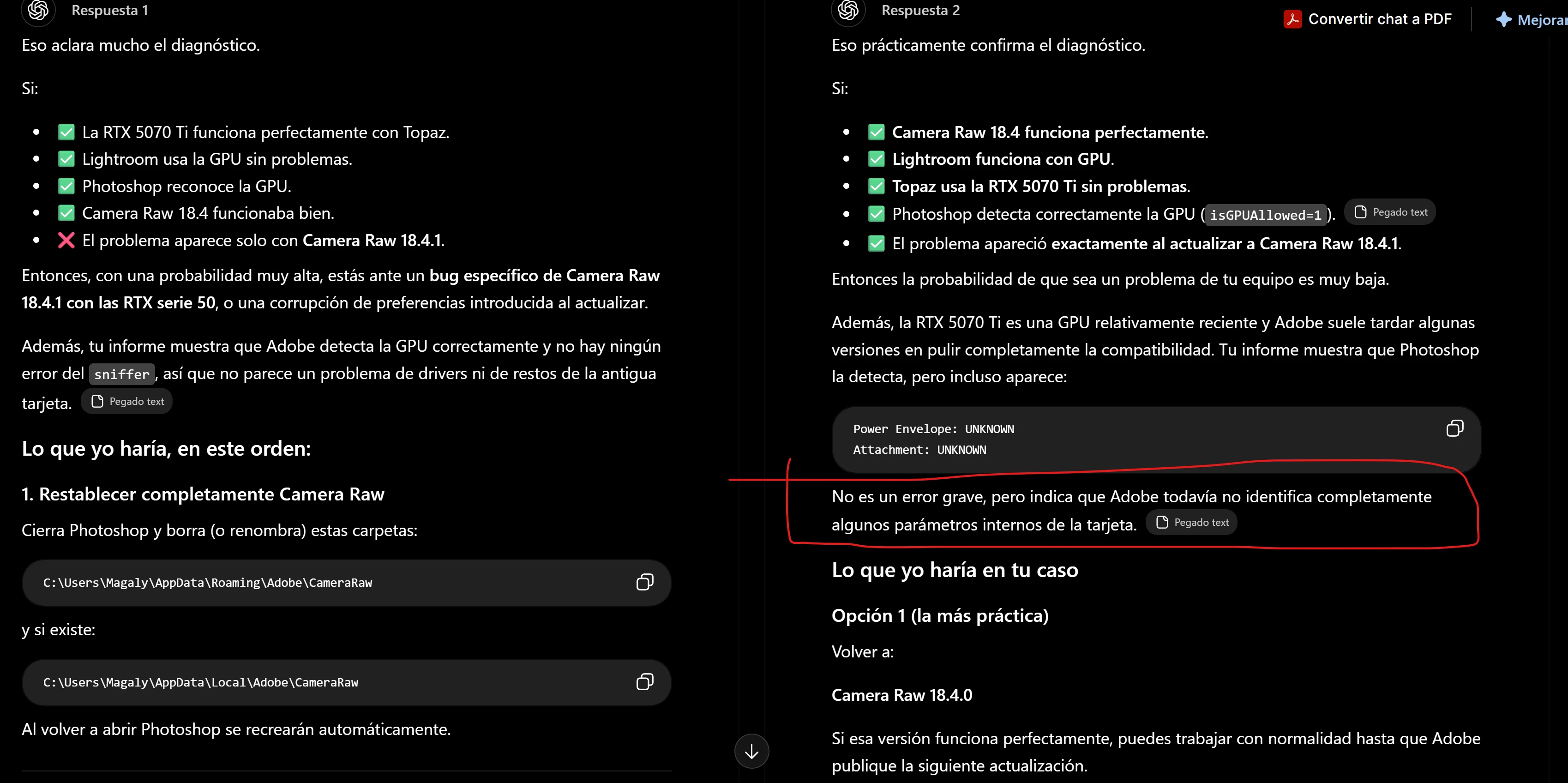

    After copping System information in ChatGPT, su respuesta fue ésta:
    I think the issue is only in Camera Raw 18.4.1.
    It's not a serious bug, but it indicates that Adobe still doesn't fully identify some internal card settings.
    If it's exactly that version jump, it would pretty much confirm that it's a bug introduced by Adobe and not a problem with your team

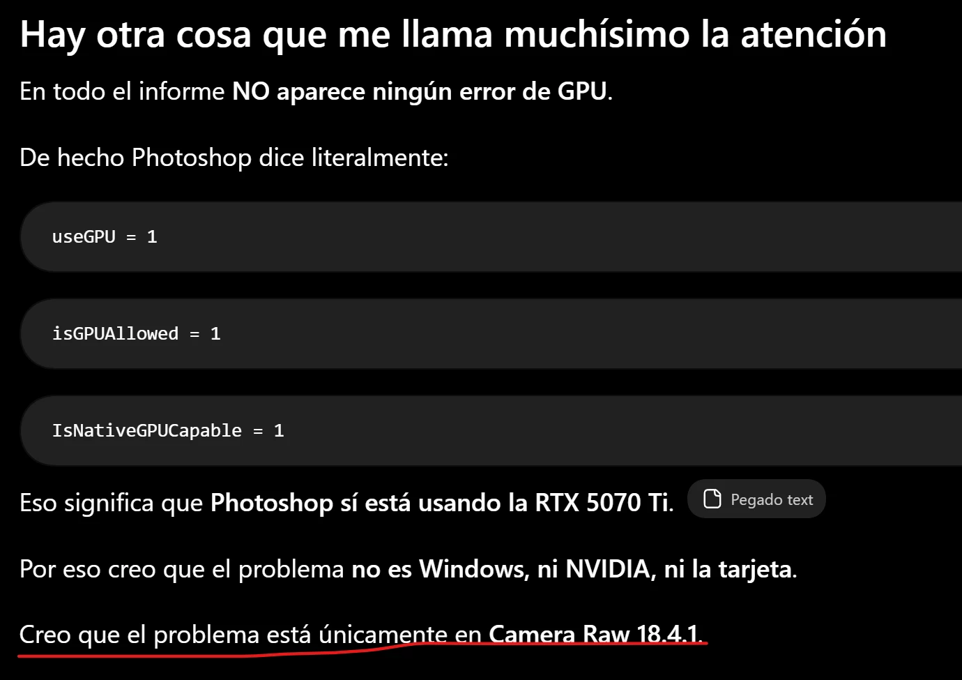

    ChatGPT
    Now I would completely rule out a GPU issue.
    The fact that it happens:
    when opening a RAW from the Explorer,
    when opening a RAW from Bridge,
    and also when using Filter → Camera Raw on a JPEG or TIFF from Photoshop,
    means Camera Raw doesn't even get to initialize its graphics engine. It is not a specific function (such as AI or Noise Removal), but the Camera Raw module itself that fails at boot.
    In addition, your Photoshop report demonstrates that the GPU is fully operational and that the sniffer does not detect any issues.
    My diagnosis
    With everything you've contributed, I'd say there's a Camera Raw 18.4.1 bug in your installation, not a Windows or RTX 5070 Ti issue.
    There is one detail that makes me even more suspicious: you have Photoshop 27.8 (2026) with Camera Raw 18.4.1. That combination is very recent and the RTX 50xx have still required several tweaks by Adobe in previous releases.
    Plus there's a test that makes me dismiss it almost completely

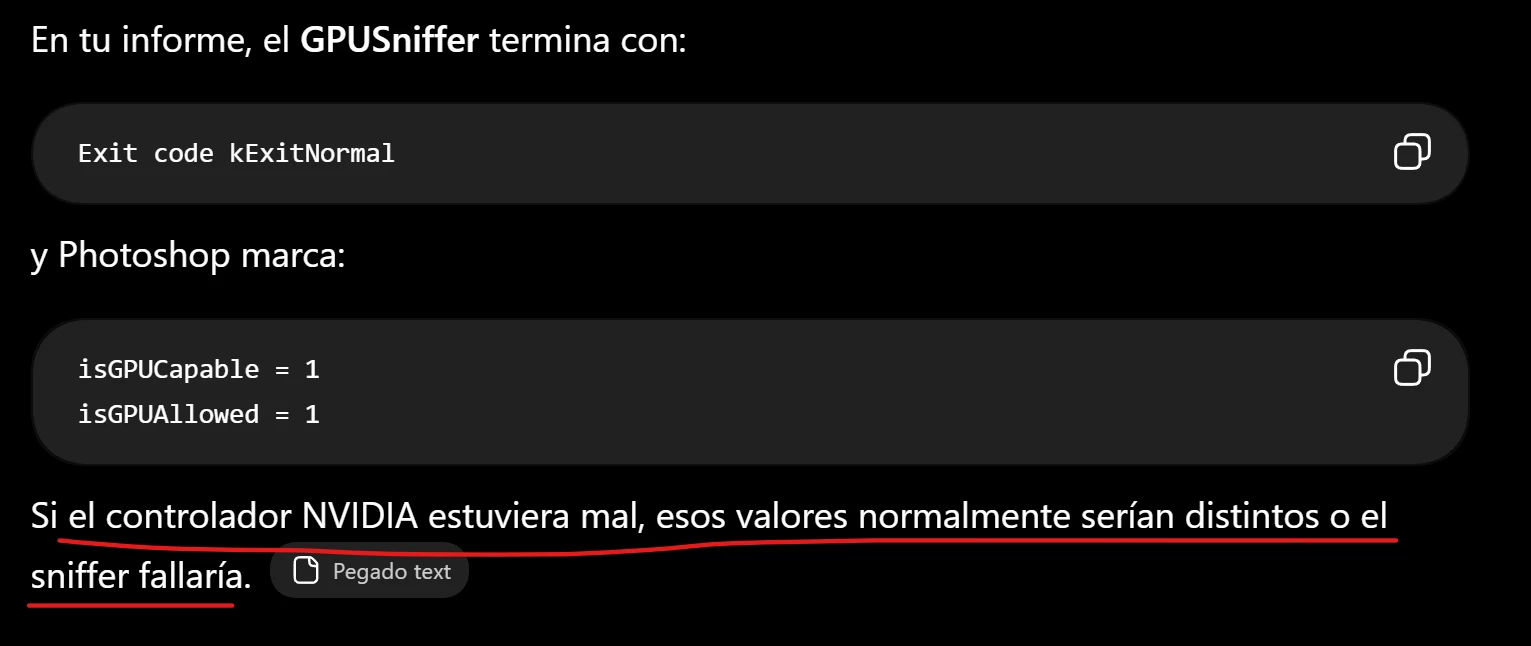

    In your report, the GPUSniffer ends up with:
    Exit Code Normal
    and Photoshop marked:
    isGPUCapable = 1
    isGPUAllowed = 1
    If the NVIDIA driver was bad, those values ​​would usually be different or the sniffer would fail.

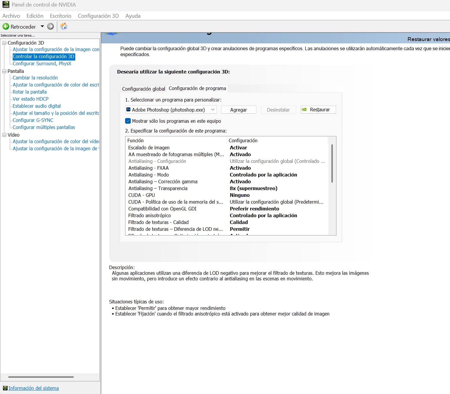

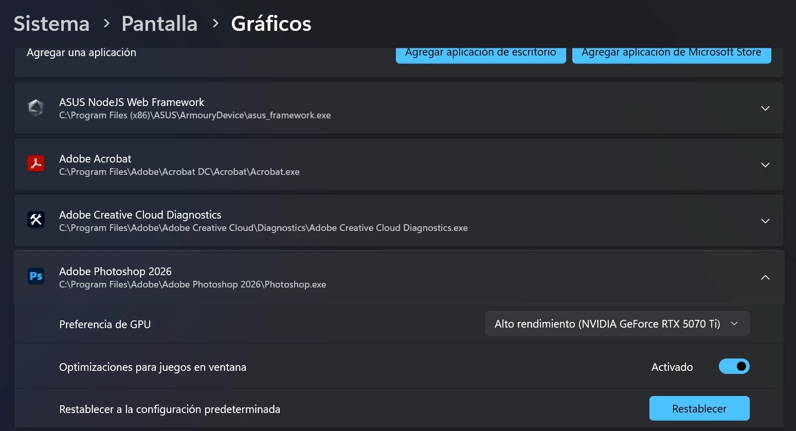

    Hi ​@Sameer K :
    Hello.
    Thank you very much. The new NVidia driver just came out, (July 28th), I installed it, and the problem continue.

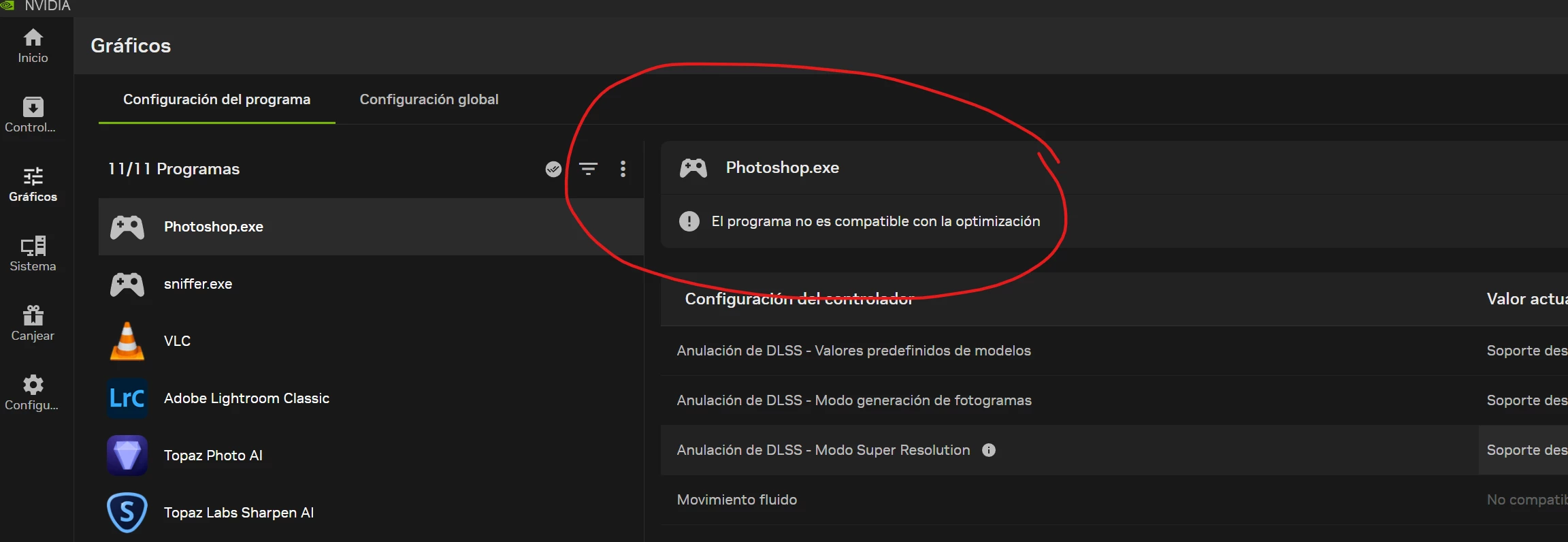

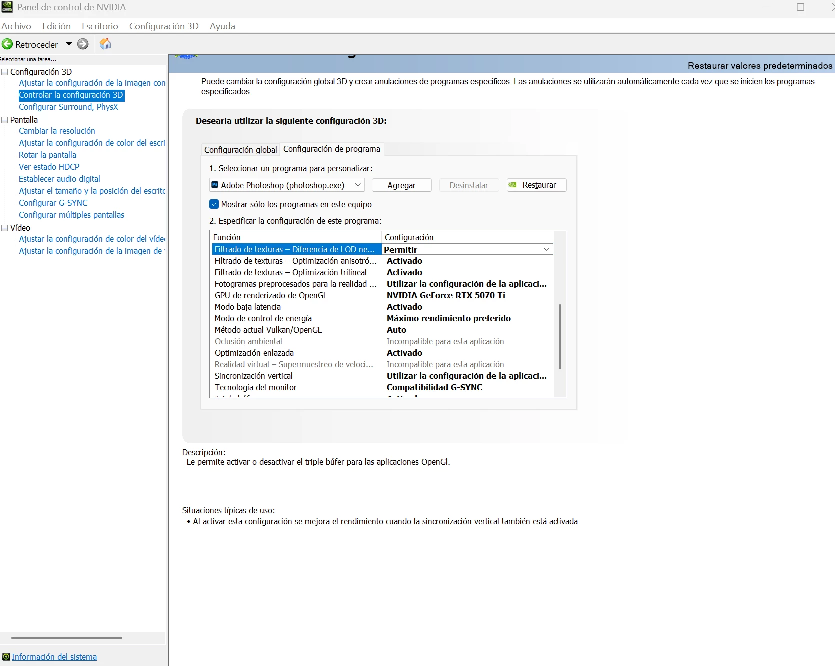

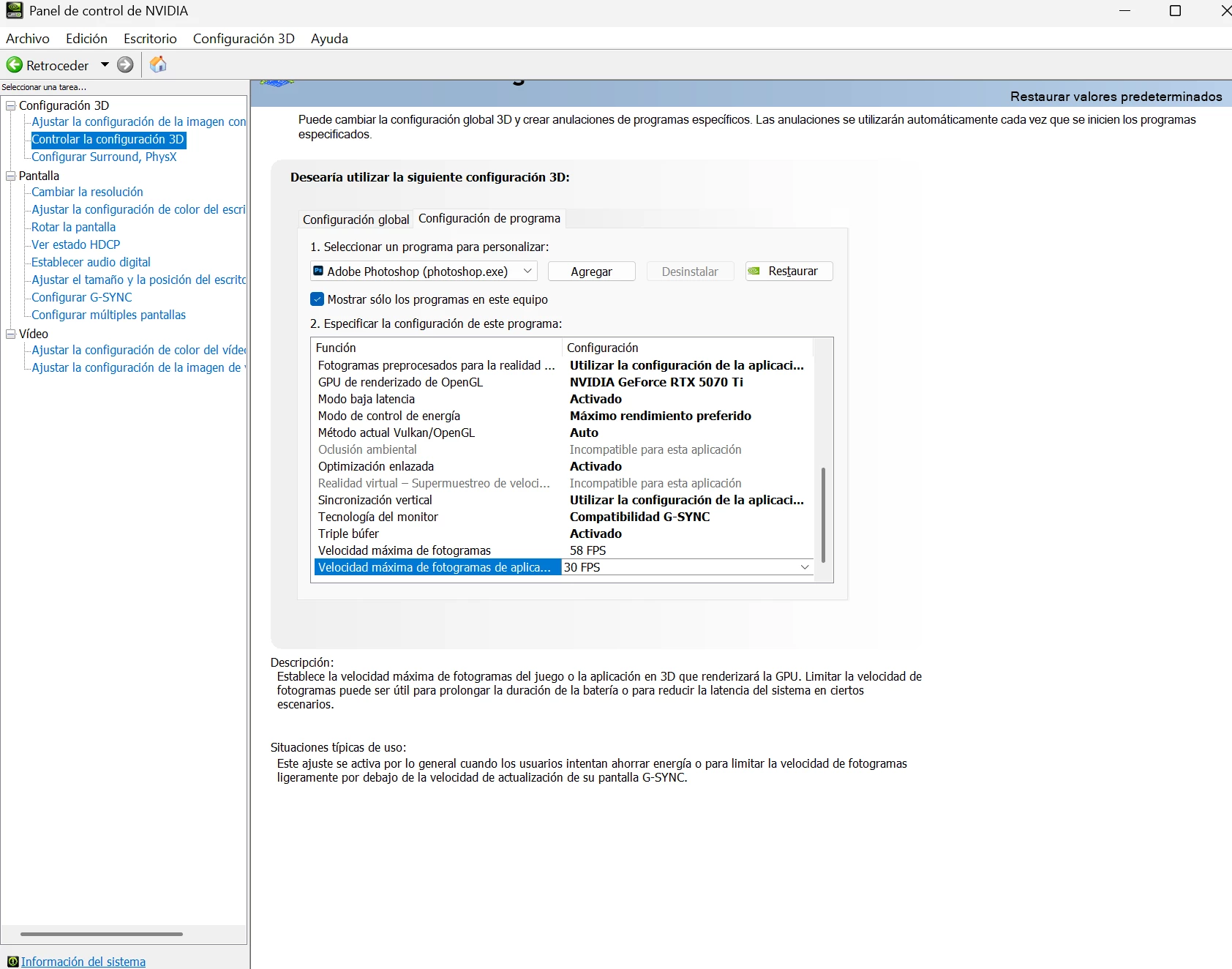

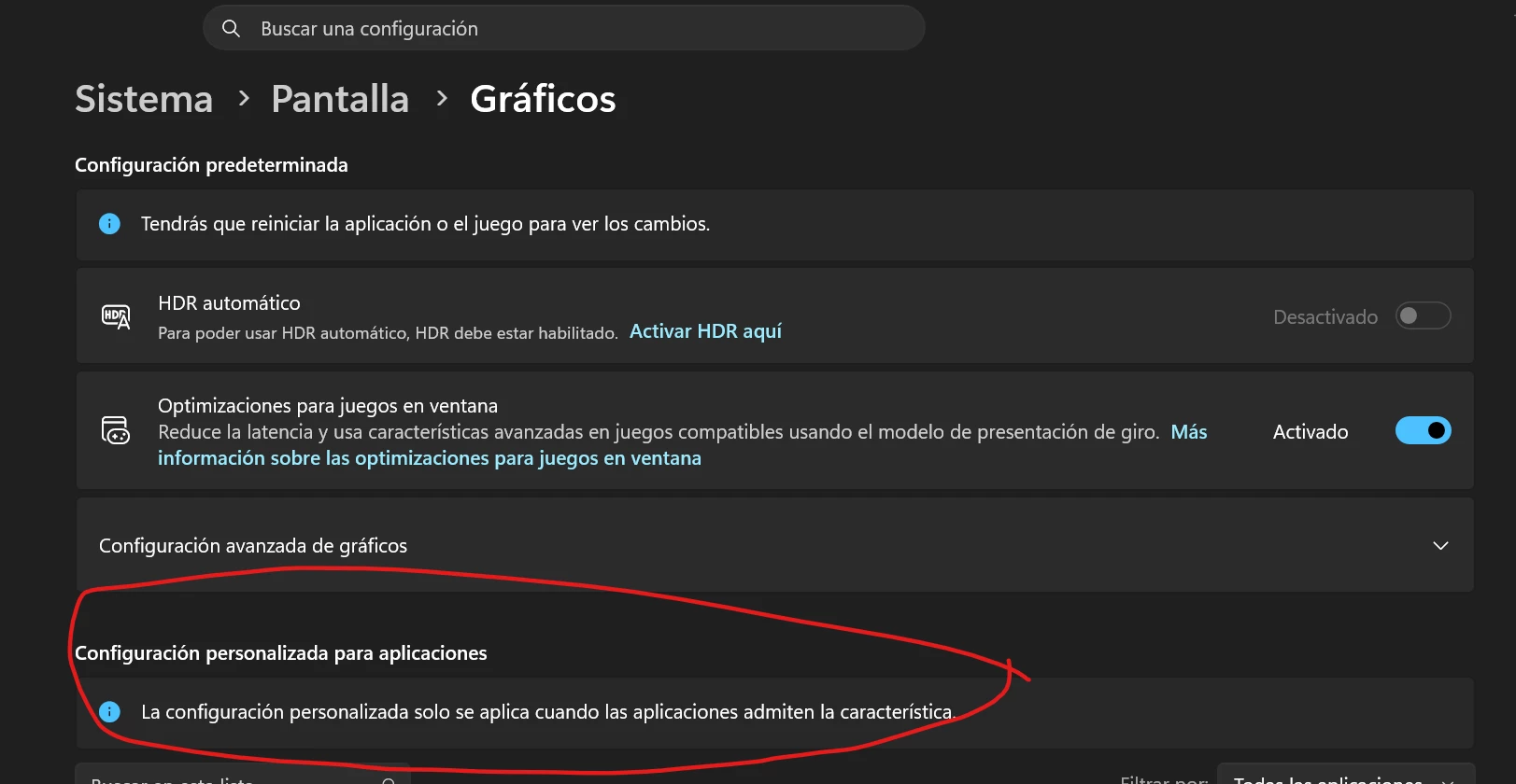

    I tried to do what you suggest, but, on the one hand, now Windows controls the performance (Settings/Display/Graphics/Add Desktop App/GPU Preference/High Performance)
    Configuration in Windows
    And on the other hand, in NVidia app you cannot select "High performance" (dot 2 does not exist). It's like breaking down each "function/property). I configured what I intuited (although apparently it's now Windows who controls)
    From the NVidia desktop app it's the same.
    The program is not compatible with optimization
    And in Windows "Custom setting only applies when apps support the feature"
    So I'm still the same, without being able to use the latest version raw camera, which is not losing much either, but if an update comes with important changes ....
    Thank you
