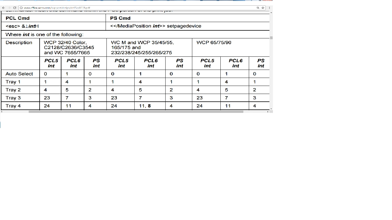

For Postscript V3.0 drivers as I have customized driver  as per our requirement  to select input tray as “Tray 2” for page 1 (Printer model :- APEOSPORT-V C5575),
I checked document on XEROX website http://www.office.xerox.com/support/dctips/dc05cc0359.pdf(Page7)  as mentioned below,
And per shown above I programmed to send the output to tray-2 for first page .But unfortunately I couldn’t get any output from tray-2 ,but rest of the pages came from other trays where input tray’s default setting has been done .
Could you please validate if following PS code which has been sent to printer is correct to take input from tray-2.

May 22, 2017 1:33 PM UTC
Try /MediaPosition 2
(2) is a string and it should  be an integer.

May 23, 2017 12:38 PM UTC
%mark {
<</MediaPosition (2)>> setpagedevice
%} stopped cleartomark
The stopped is catching your error, if you remove it as shown above with the comment = %
the code errors. Just try changing (2) to 2.
