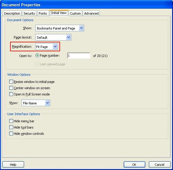

But when I am tried for Fit Page it will work
Script for Fit Page (Working)
[ /PageMode /UseOutlines /Page 1 /View [/Fit] /DOCVIEW pdfmark

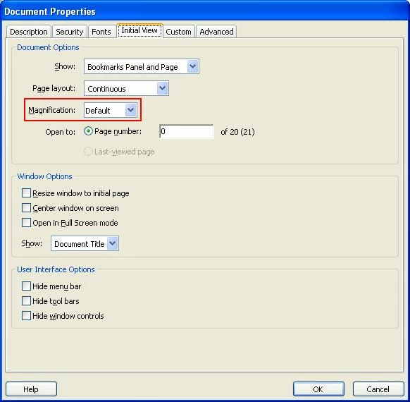

Script for Fit Width (Not Working)
[ /PageMode /UseOutlines /Page 1 /View [/FitB] /DOCVIEW pdfmark

When I am tried in alternative way with help of {Catalog}  /PUT pdfmark the Fit Width will work but not updated in Initial View  Magnification field. But Fit Page will work and also updated in the Initial View  Magnification field.

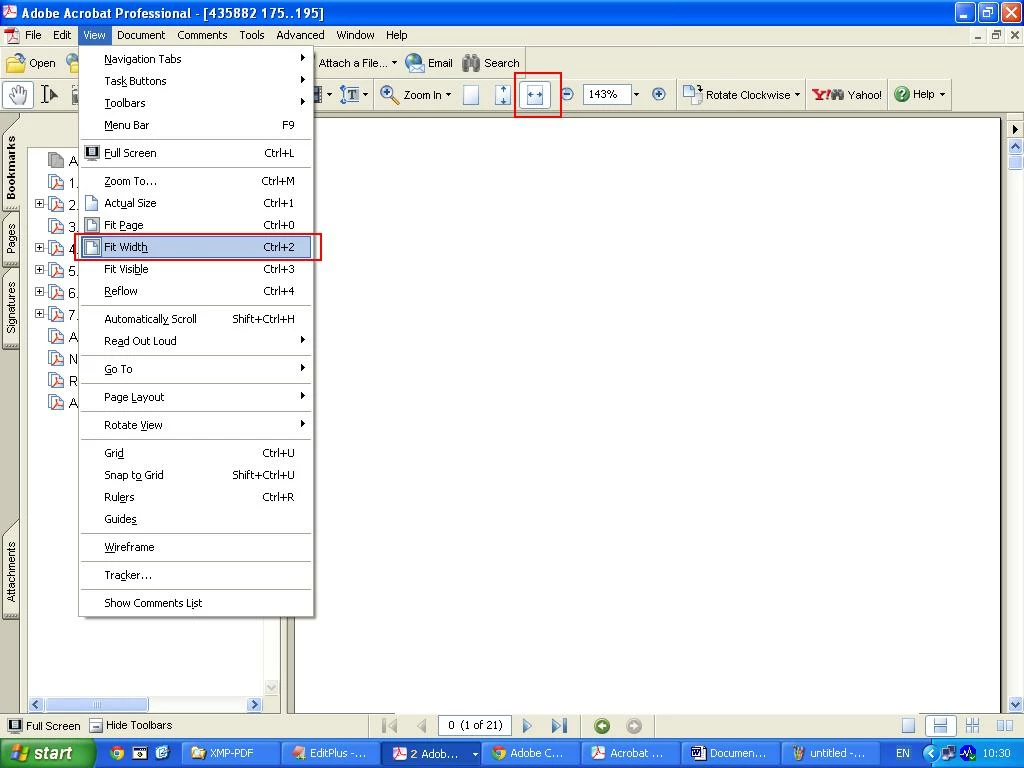

When I am open this same PDF in Adobe Reader the zoom level will be in FIT WIDTH only for {Catalog} Fit Width.
Screen shot for Fit Page.
Screen shot for Fit Width.
From the above screen shot I am marked in red color for your clarification,
