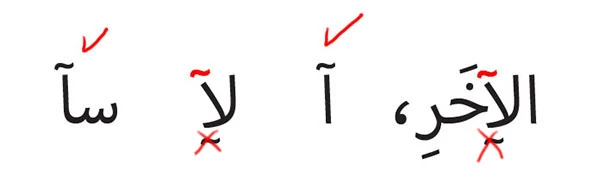

1- The wavy line (Madda) above the "Alef", when used with "Lam" (L) the Madda goes below the "Alef" (the Madda is always above the "Alef". See attached image, The red is the correct placement.
2- Same problem for Hamza, when used above "Alef" when the letter joined with "Lam" it goes below the "Alef". See attached

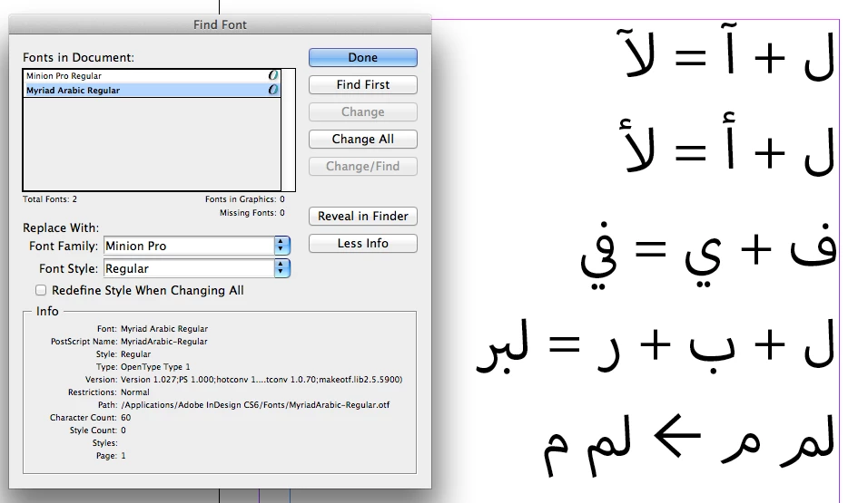

3- The third Problem is just when Ligature is on. The letter "Yeh" when it connect with "Teh", "Feh", "Beh" it becomes wrong. See attached example of Feh (F) + Yeh (Y)
4- Is a problem with the dot of the "Bah" (B). When the "Bah" comes after a "LAM (L) the dot falls very low see attached file.
5- Another problem is with Diacritics, whenever is used on  a Ligature character, they overlaps. However this can be fixed with controlling the diacritics horizontally.

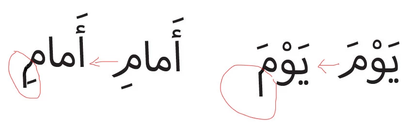

6- is a wish. Can we have an alternate Glyph for the "Mim" M when it's at the end of a word?
The reason I'm asking is because I work in Education and the font is excellent for use in educational books because of its legibality, and cleanliness. However the font got rejected from schools because the "Mim" (M) (when it is a the end of the word) it's not very obvious for kids. The shape is more stylistic than traditional and it get confused by kids for a "Ra" (R). see attached sample.

Michel,
Thanks for the details.
I tested the font in InDesign CS6 Mac and everything worked as expected.
Also, the alternate form of the Meem exists in the font already; to get it you need to use Stylistic Set #3.
See screenshot below.
