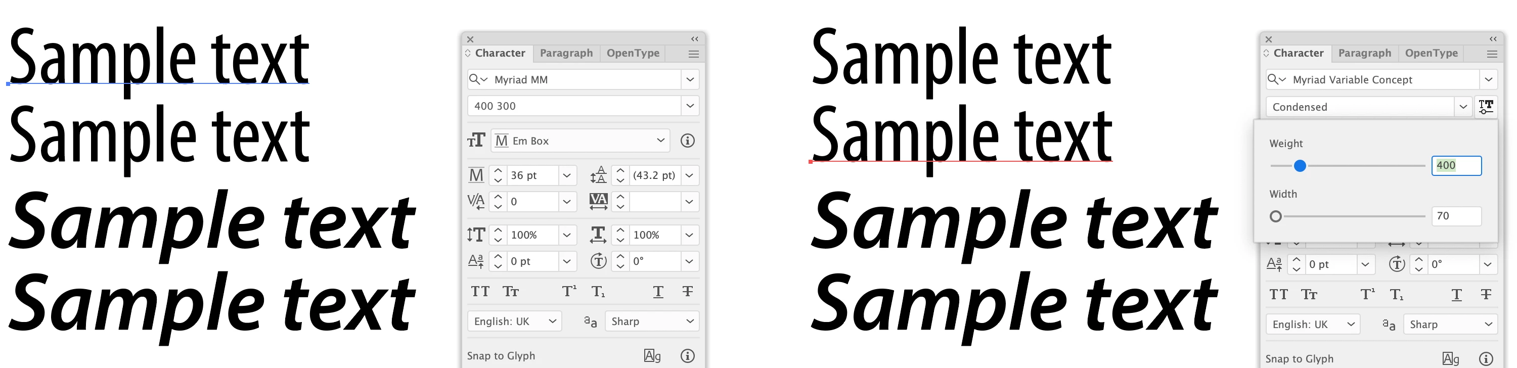

Well, it’s come to this! I’m re-printing some old J-Cards in which I used custom values for Myriad Multiple Master. For instance:
Myriad MM 400 wt 300 wd and
Myriad MM 565 wt 600 wd and the like.
Does anybody know where I might find a conversion table or any kind of resource to convert those values to the equivalent in the two axis in Myriad Concept Pro?  If not, I can probably just eyeball it, or print it up using a very, very old Mac with Myriad MM installed. Updating would be the best solution though.
Thanks in advance,
Tom

    Tom:
    The quick answer:
    Myriad Regular Condensed is:
    • Myriad MM 400 WT 300 WD (Multiple Master)
    • Myriad Variable 400 WT 70 WD (OpenType Variations)
    Myriad Semibold (Normal Width) is:
    • Myriad MM 565 WT 600 WD (Multiple Master)
    • Myriad Variable 600 WT 100 WD (OpenType Variations)

    Fortunately, there is a way to convert Myriad MM settings into Myriad Variable settings. It’s not exactly pretty, but it works. And these numbers are courtesy of my colleagues in Adobe’s Type Group, who designed and produced versions of the typeface over the past few decades:
    MYRIAD WEIGHT AXIS
    Multiple Masters (MM)
    • Range = 215 to 830
    OpenType Variations (VAR)
    • Range = 300 to 900
    Standard Weights
    • MM 215 = VAR 300 = Light
    • MM 400 = VAR 400 = Regular
    • MM 565 = VAR 600 = Semibold
    • MM 700 = VAR 700 = Bold
    • MM 830 = VAR 900 = Black
    MYRIAD WIDTH AXIS
    • Range = 300 to 700
    • Range = 70 to 110
    Standard Widths
    • MM 300 = VAR 70 = Condensed
    • MM 510 = VAR 90 = Semi-Condensed
    • MM 600 = VAR 100 = Normal
    • MM 700 = VAR 110 = Semi-Extended

    Returning to Myriad: how does the Multiple Master version compare to the OpenType Variations version? The answer isn’t entirely straightforward, but depends upon the primary font instances from the original Myriad MM design.
    If you take a look at the tables of numbers above that directly convert Myriad’s MM values to their Variations equivalents, you’ll notice that there’s not exactly a direct relationship between the two sets of numbers. That’s because Myriad MM has linear axes, and Myriad Variable doesn’t.
    In other words: the weight exactly halfway between Myriad MM 300 WT and 700 WT is 500 WT. This is not the case with Myriad Variable: you’ll need to experiment yourself to find a precise visual match between a custom weight of Myriad MM and its Myriad Variable counterpart.
    Fortunately for most people, they never bothered to generate custom versions of Myriad MM. So it’s highly likely that the old layouts you want to rebuild simply used the default Myriad MM weights and widths. And if that’s the case, then all you need to do is to refer to the two conversation tables above – and your problems are solved.

    I just did a test myself with an old file that just HAPPENED to have the two weights you mentioned.
    For the first, Myriad MM 400 300 matched Myriad Variable Concept Condensed exactly (Variable : 400 70)
    and the second, Myriad MM 565 600 matched Myriad Variable Concept Semibold Italic exactly (Variable : 600 100)
    So it shouldn't take too long to find good matches to your existing MM instances.

    All good guidance, Brad! I used your method and I believe our numbering schemes must differ as the widest number I have for the width axis in my version of Myriad Variable Concept is 110. So the second instance, 565 wt - 600 wd translated to 408 wt - 100 wd, which is fairly close to Regular (but not italic). Using those values lined up pretty well against the original fonts when I checked it out in Illustrator. It also looks close to how the original J-Card appeared when printed (which I still have). The first, 400 wt - 300 wd is very close to condensed, though again, in the variable numbering scheme of my version of Myriad Variable Concept it is listed as 400 wt - 70 wd. Regardless of the numbering, I have a good method now, so thank you again for that!
