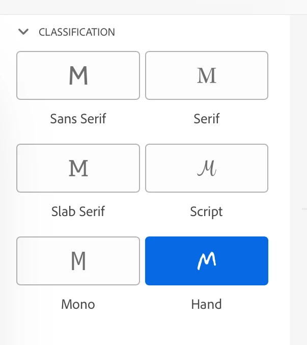

Try using a search engine with the search terms "create font from hand lettering" — it appears that there are a number of non-Adobe apps that can do this.
One thing you can try using Adobe apps is to go to Adobe Fonts and filter the Classification to "Hand" to see if any of those work for you.
