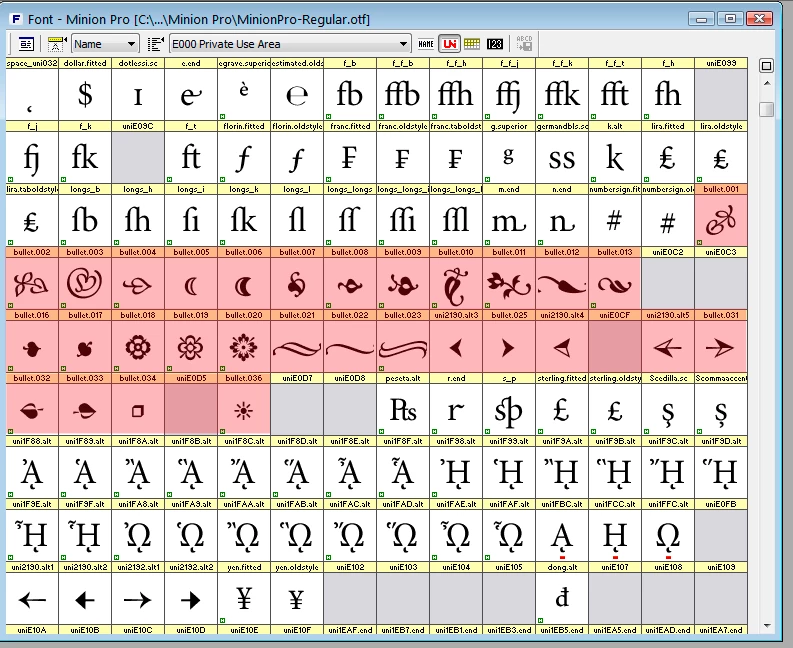

our customer stumbled about the symbols from E0D5-E0D8. In the new version three of them were moved to 2713,2733,2734.
What raises the question what more has changed....
In the upper part is the old version. Below the new version of Minion Pro.
Jochen

Apparently, a correction was made to move the glyphs into their proper Unicode positions instead of private use area.
Do you know of any glyphs that got lost moving to the new version?
