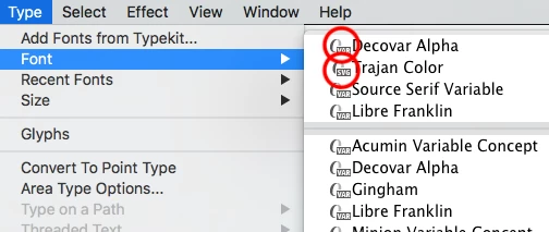

Once you load one of the new font you technologies, you will notice the font appears with the new opentype icons with either VAR or SVG in them.
Get to the variable type options

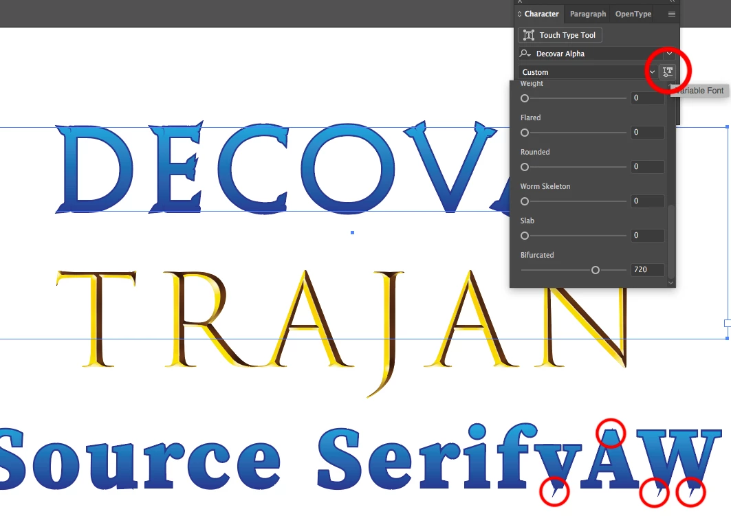

Look for this icon
Unfortunately the window will not expand fully so you will need to scroll
Trajan is an svg font, with multiple colors that comes with with 2018 update. You cannot change the color or swatch son the font, unless you outline the type to paths.

Some fonts such as Source serif are giving me some sharp edges, which go away if you go to the stroke palette palette and change limit check newly the defat of 10.

    I've opened an issue on the Source Serif Pro repository requesting an enhancement that hopefully will address the sharp edges problem you mentioned.
