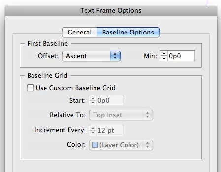

    The outlines of Gill Sans seem like they haven't change. The one difference I see is the position of the first baseline. This happens because Type 1 fonts don't have a OS/2 table which holds vertical metrics values. In InDesign, to control the position of the first baseline and the baseline grid, use the 'Baseline Options' pane of the 'Text Frame Options' dialog.
    As for Minion, design and spacing changes were made during the conversion to OpenType, as documented in this page http://www.adobe.com/type/opentype/T1_to_OTF_FAQ.htm
