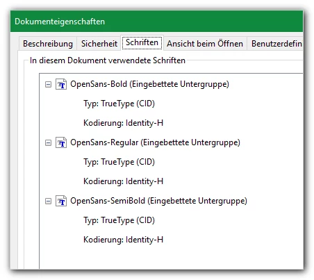

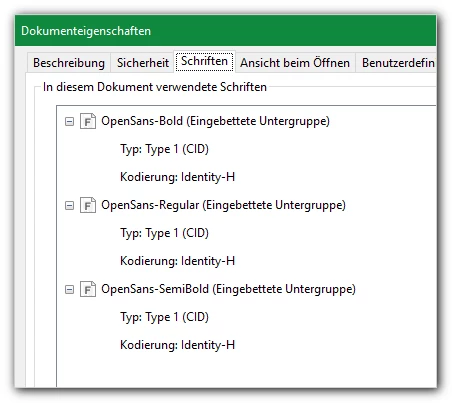

the screenshot on the left shows the font properties of a PDF document which I created last year (not with a Adobe application).
On the right the properties of the updated document on a new PC which has the latest versions of Open Sans installed (source: https://fonts.google.com/specimen/Open+Sans)
The appearance of the "older" PDF is much better than the updated one: "TrueType" vs. "Type 1".
I am wondering why Google do not have the, hmm, TrueType/OpenType version of this font in its repository (anymore?).
Question: it would be better to search for the "older" versions of Open Sans (TrueType) which I used last year instead of using the latest versions (Type 1) – in  view of  https://helpx.adobe.com/at/fonts/kb/postscript-type-1-fonts-end-of-support.html AND to get a better quality of the PDF?
Thanks!

The simple answer:
Any version of Google’s Open Sans that you use is really in OpenType format, dating all the way back to the font’s original 2011 release. You don’t have to worry when Adobe discontinues support for PostScript Type 1 fonts in January 2023: your PDF files will continue to open and render correctly.
As for which version of Open Sans produces a better-quality PDF: there’s no effective difference between the one with TrueType font data, and the other with PostScript Type 1 font data. Text may render slightly differently on low-resolution screens, but text will render identically on high-resolution devices and in printed output.

What you’re seeing in the ‘Fonts’ tab of Acrobat’s ‘File > Document Properties’ dialogue box is something that occasionally happens when you create PDF files from InDesign and other applications.
Even though you deliberately use only OpenType fonts in your working documents, Acrobat identifies the generated PDF file as using PostScript Type 1 and TrueType fonts instead. This can be frustrating – and feels somewhat misleading – but there’s a reason why this happens.
If you notice in both screenshots, the PDF file’s embedded fonts are listed as ‘TrueType (CID), Identity H’ and ‘Type 1 (CID), Identity H’ format. CID is a way of encoding font data to support large and complex character sets, beyond those typically used in German and other Western European languages.
When you generate a PDF file from software like InDesign, an OpenType font may be converted into CID encoding when it is embedded into the PDF. Whether the font is listed as being ‘TrueType (CID)’ or ‘Type 1 (CID)’ in Acrobat depends upon the font data in the OpenType fonts that you’re using. OpenType fonts can use either PostScript Type 1 or TrueType data to describe the shapes of characters; this is why Acrobat’s ‘Fonts’ tab looks the way that it does in your screenshots.
As for which format Google normally uses for fonts like Open Sans: they generally issue OpenType fonts with TrueType font data. These fonts are available directly from Google (https://fonts.google.com/), and from other websites like Font Squirrel (https://www.fontsquirrel.com/).
In my experience, all the versions of Open Sans that I’ve downloaded over the years – going all the way from version 1.1 (2011) through to version 3.0 (2021) – are in OpenType TT format. However, I am aware that versions in OpenType CFF format – that’s OpenType with PostScript Type 1 font data – do indeed exist. If you have a font editor, you can convert font files between the two OpenType formats quite easily.
Which format of Open Sans is better? That’s a moot point: they’ll produce exactly the same output on high-resolution printers and screens. The visual differences that you might observe on lower-resolution screens and with very small text is because of the way that text is rendered in each particular situation. And those differences will depend upon the device, the screen, the operating system, and the application that you’re using to view the text.
Adobe’s own applications – including Acrobat – typically use a text renderer that’s part of their Adobe Graphics Model (AGM) rendering engine. Some applications fall back on the operating system for rendering: a good example is Apple’s own PDF viewer ‘Preview’. Other applications use their own text renderers.
If a font has special rendering instructions known as ‘hinting’ manually built into its data file, the rendering quality of the text you’ll see on low-resolution screens will be marginally better. If no manual hinting instructions are included in the font, you can expect to get slightly poorer text rendering; how much worse will depend upon the typeface’s letterforms.
If your copy of Open Sans is the OpenType version with TrueType font data, then you’ll notice that small text and text on low-resolution screens renders more consistently, but slightly blurrier than the OpenType version with PostScript Type 1 data. This is because TrueType has a feature called ‘automatic hinting’: that means text renders quickly and reliably, without the need for type designers to spend lots of time manually hinting their fonts. Automatic hinting is a nice feature, but be aware that it will produce rendered text that looks slightly bolder and blurrier.
If the intent of the PDF documents you’re creating is for print only, then I wouldn’t worry about which version or format of Open Sans you choose to use. If you’re producing PDFs exclusively for screen reading, then you’ll need to decide whether you prefer the text rendering of the OpenType CFF (Type 1) or OpenType TT version better.
Keep in mind however, that what you see on your screen may not be what your readers see on their screens. Always design with the final intent in mind, and calibrate your own systems to match.

Google fonts are all OpenType. Internally, an OpenType font may use TrueType (quadratic) or PostScript (Bezier) outlines, but in either case it is an OpenType font. A given font file may not implement most features of the OpenType format, especially if it was simply converted from its original format to OpenType with a utility such as FontLab's Transtype, but it remains an OpenType font.
The Adobe announcement about ending support for Type 1 fonts applies only to actual Adobe Type 1 font files, not to OpenType fonts. This is a case where the unfortunate ambiguity of the terminology makes a simple situation quite confusing for most people.
You don't say in what way the appearance differs between the two versions of the document, but you have given a good example of one of the frailties of relying on cloud-based font services. If a font version changes, a document that was set using an earlier version may have unexpected text reflow or other issues. For this reason, it is good practice to download a copy of the exact font used in a project and keep it available. Font managers such as Extensis Suitcase Fusion can store multiple versions of a font and will use the correct version for a given InDesign, Illustrator or Photoshop document so that issues don't arise.
Open Sans is appropriately named. It is open source software and its repository is public here on GitHub. It is not "stored by Google in its repository." Apart from the fact that GitHub itself is owned by Microsoft, open source projects are not "owned" by anyone other than the people actively contributing to them. You can reach the font developers by reporting what you are having difficulty with on the "Issues" page of the repository.
