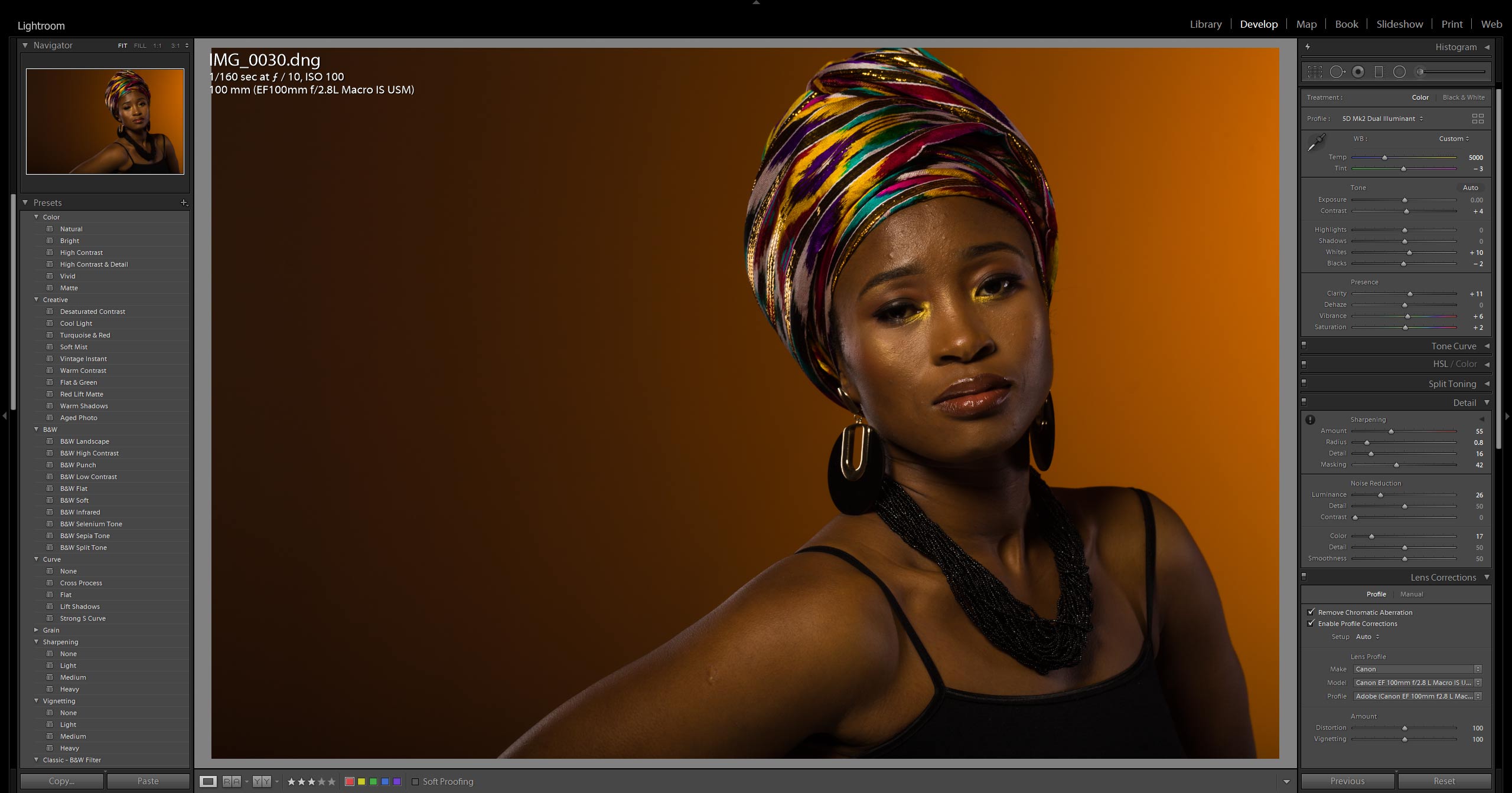

I have uploaded a representative image if people wish to see. The image should have an embedded custom camera profile created by the passport software. It is dual illuminant in case that is a factor. I am wondering if this is a factor since the profiles have been moved and changed in this release. I embed my custom profile in the dng. Can people see the profile?
A link to my DNG with custom Camera Profile

I'm not seeing any problems or crashing which suggests it could be a hardware issue. The photo was edited using process version 3; so you could update to P/V 4 (current) in Camera Calibration to see if that makes any difference.

I’m having no problems using the sliders with your image or zooming 1:1
