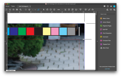

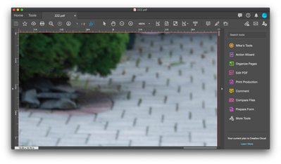

Unfortunately you can't remove the bleed content alone.  I'm not sure if this is what you're after, but you can create a custom fixup to set page geometry boxes.
You would want to set the Media box relative to the Trim box. Again you can apply\assign that Preflight profile to run in a Action Wizard action to allow you do a batch of files in one go.
Before;
After;
