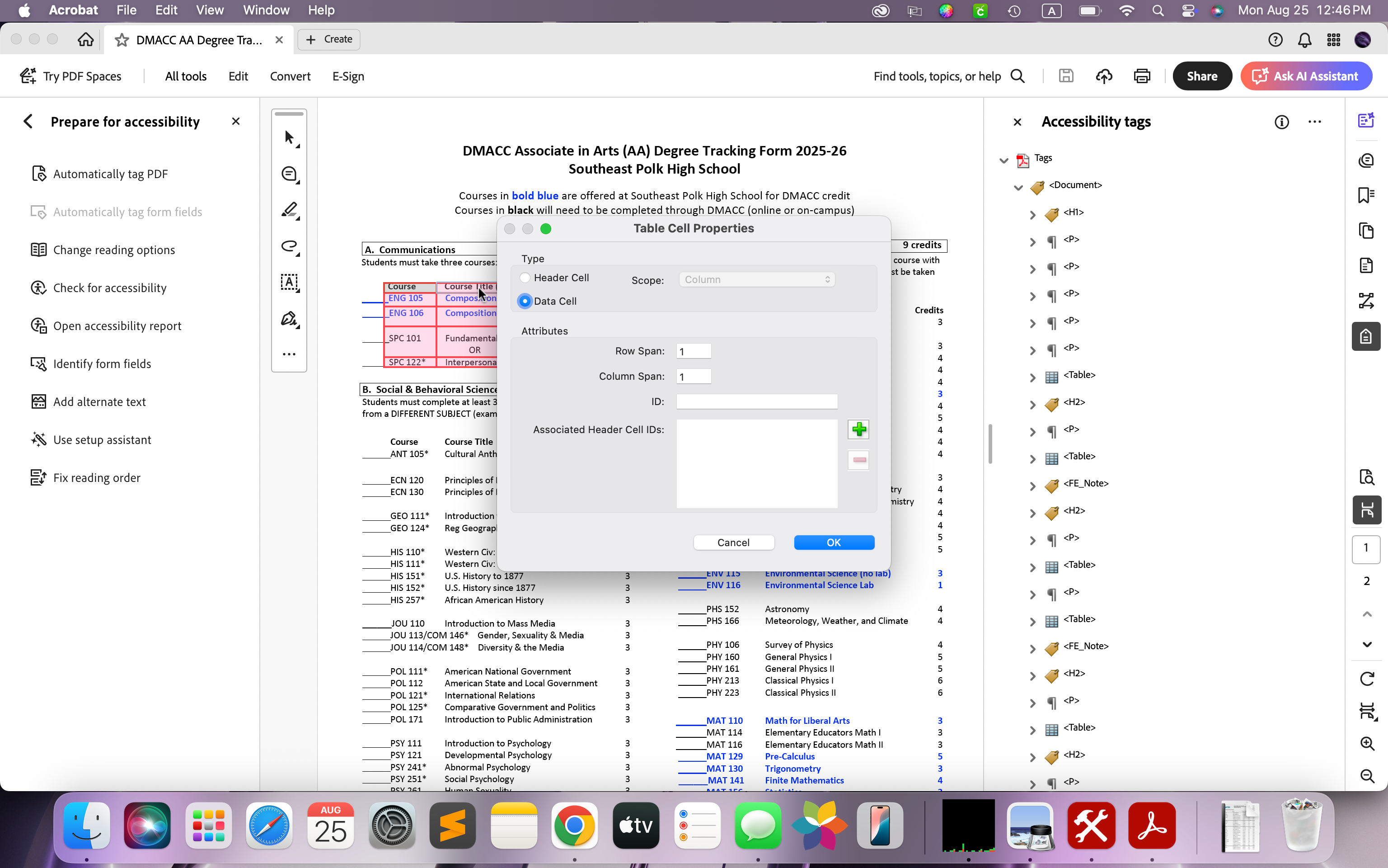

I too am having issues with the accessibility tool not working correctly. I did to the uninstall with the Adobe Cleaner tool and a fresh install via the link you provided in the instructions above. I continue to have issues getting table header cells not changing to table header cells. I've tried by typing "H" in the tag and it goes right back to a TD tag. I've also tried changing it via the reading order tool and the table editor. My edit doesn't stay.
Mac OS Sequoia 15.6.1
Adobe Acrobat Continuous Realease version 2025.001.20630
Any help would be greatly appreciated.

With the document I sent you, after I did the auto tag, I was able to change the tags correctly.
However, what happens when I can't use the cloud based auto tagging??
I've attached a PDF that is larger. I work with documents that are larger than the cloud based allows so the auto tagging doesn't work correctly.
With the new document I attached, I'm still having the issue with the table tags not switching to a TH from a TD no matter what I do to the document. Thank you for your continued work to help get this solved. Let me know if you have any other questions.
