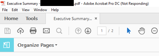

Original report: After installing the trial of Adobe Acrobat Pro DC and it froze every single time the application was opened; I got maybe 5seconds before it locked up completely. I'm on a very recent build both PC and Windows 10, top specs 7700K, 16GB DDR4 Ram, SSD, NVidia 1080, etc etc...
Update to this: It seems to behave like the above more-so immediately after install, until background processes for Adobe Acrobat Pro DC have settled themselves down (give it some time, perhaps an hour), and then doesn't freeze as frequently.
Can anyone comment on this, regarding current build 30/08/2017 downloaded directly via adobe.com, to trial?
Do you find the that background processes for Acrobat Pro DC, cause it to crash? Is that a fair assessment?
Could it be the licensing suite?
Another thing is that it initially said I have 7days to trial but then inside the program it says I have 30days to trial.
So, maybe it is a conflict with the licensing suite as part of the background Adobe processes? - not sure

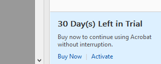

There is a dialogue that says "Buy now to continue using Acrobat without interruption."
Just being devils advocate, but surely the trial isn't designed to make people suffer through, with whatever background processes to continually check the trial status, locking up the application and rendering it useless unless you give in to buying?
Well, I certainly will be taking the trial as evidence of what to expect from the application if I purchased it, so I'm not encouraged to spend money on it, given my experience so far.
