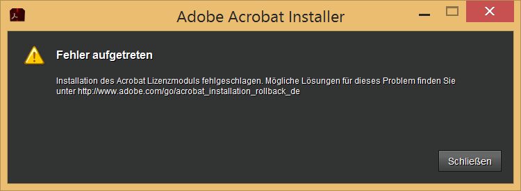

Installation des Lizenzmodul fehlgeschlagen
or
Failed Installation of License modul
HELP!!
After installation of Acrobat DC everything went smoothly up to 70%, then error
I tried to remove older installations but always the same.Cleaned registry, always the same. I use Windows 7 64-bit. Please help!

I have same trouble as Nr. 33
PK-911
I get same error message (licence mgr). I have win 7 - 64bit Laptop
I deinstalled adobe XI trial before, which worked great during test period,
cleaned registry and folders manually and used MS tool from above.
Still same error message "Installation des Lizenzmodul fehlgeschlagen"
Adobe should make clean&easy installers
or I want my money back!
