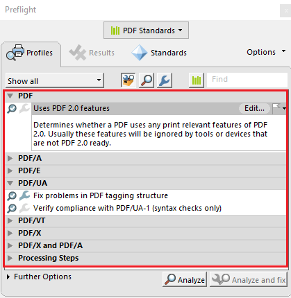

Hi there,
I have a customer that is unable to load Preflight properly. When it opens, there is nothing shown under 'Profiles' tab. I have tried changing the drop down at the top to show 'PDF standards' and under 'Profiles' I put the drop down box to 'Show all' however there is still nothing. I have checked my own Adobe Acrobat DC and it loads the profile with no issue. On top of removing Preflight and adding it back in, I've done a repair on Adobe Acrobat, reinstall and pushed a newer version of the software over. Photo attached is what it's supposed to load automatically. Red lining is everything that is not loading and showing blank on the customer's side.

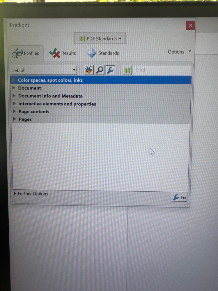

I am having the same problem I have the newest version of acrobat 24.1 on windows 11 and preflight loads  but all the tools are blank
If I try to switch from PDF standards I get a pop up error message "unable to copy the user specific preferences.
I followed all of the previous advice and nothing has worked. Please help.

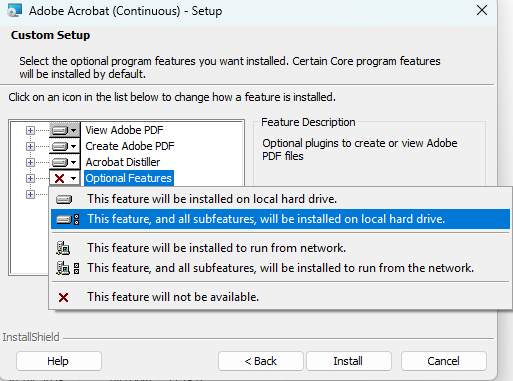

Preflight is an optional tool and is installed once you invoke it from Acrobat. It takes some time for downloading and installing in background and then ideally it should start working after restarting Acrobat once installation finishes. You will get updates in form of message like you are seeing "Preflight is installing. Please wait to use this tool" and so on.
If it is still not working after few minutes , then it appears there is some issue in setup which needs to be looked upon. However to unblock you at this time , can you follow the steps mentioned below after closing Acrobat :
  1. Go to Control Panel --> Programs --> Program and features
  2. Select Acrobat and Click on "Change" option (screenshot below for reference)
  3. This opens the Acrobat setup window. Now select "Modify" option here.
  4. Select "Optional Features" dropdown and select option "This feature and all subfeatures will be installed on local hard drive."
  5. Click on Install .
Preflight will be available after installation. Let me know if this works for you.
