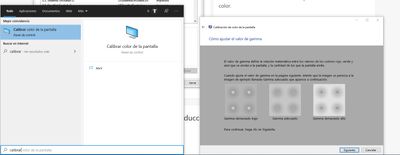

Please paste what is the ICC profile you use in colorcpl.exe. Try to change to sRGB, will it fix the issue?
New Here ,
Sep 20, 2021 Sep 20, 2021
I have solved it in windows with the option to calibrate screen color.
