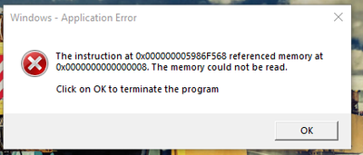

When i open a pdf, it pop up and error message,
the instruction at 0x000000005898D107 referenced memory at 0x0000000000000500.
The memory could not be read
How to solve it

if this happened on Outlook when you tyr to lauch and Adobe PDF and it opens but then you get the error, it mostly happened with the Newer version of Outlook, so here are the steps to make the message disappear.
I already updated Office (Outlook) >windows updates > Adobe and the issue persisted :
First:
  • Opened Adobe Acrobat, navigated to Menu>Preferences > Security (Enhanced).
  • Unchecked the box for Run AppContainer.
  • Restarted Adobe Acrobat.
Compatibility Settings Adjustment:
  • The issue persisted, so I checked the Properties of the Adobe Acrobat shortcut.
  • On the Compatibility tab, selected Run this program in compatibility mode for and chose Windows
  • Hit Apply and OK to save changes.
Second
  • Open Adobe Acrobat, navigated to Menu>Disable new Acrobat Reader.
If you are using the old Outlook version try: Trust Center> Attachments and see if Adobe is checked.

Jun 03, 2025 Jun 03, 2025
I carried out the first options and this has cleared the issue. Didn't need to disable the New Acrobat Reader. Thanks for the post.
