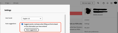

You may also try the following and check if this helps:
Go to https://adobe.ly/3A5a8lC and click on your avatar > Settings on the settings dialog, click 'Clear suggestions,' and uncheck "Auto-suggestions." Click Ok.
Let us know if that helps.
~Tariq
